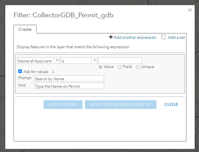

I can't get this to work at all.  When I configure a filter, and I put in a value for the filter, then try to click on 'Ask for Values', I cannot save the filter.
When I do not click 'Ask for Values' and can save the filter, my crowdsource manager shows only those points meeting the filter criteria - regardless of the app configuration.
Is there any more documentation on this?
AllisonMuise1
Deactivated User
Hi Dawn,
Did you provide a Hint and a Prompt for the 'Ask for values' filter? Although not marked, they are required and once filled out the 'Apply' button should enable.
-Allison
Dawn_Scott
Ok, thanks Allison, I'll do that.Dawn

msa4012
Hi,
I am filling in all the required information, and still not able to click on Apply Filter?
