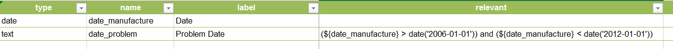

I have a use case whereby I'm attempting to build a survey to document defective Water Hydrants manufactured between 2006 and 2011. I determined that the below statement works successfully to constrain dates to between 2006 and 2012:
. > date('2006-01-01') and . < date('2012-01-01')
However, when I try to use the same statement as a relevant statement to open up other questions it fails:
${date_manufacture} = . > date('2006-01-01') and . < date('2012-01-01')
Example XLS attached.
Thanks
IsmaelChivite
Esri Notable Contributor
Hi,
this worked for me: (${date_manufacture} > date('2006-01-01')) and (${date_manufacture} < date('2012-01-01'))
