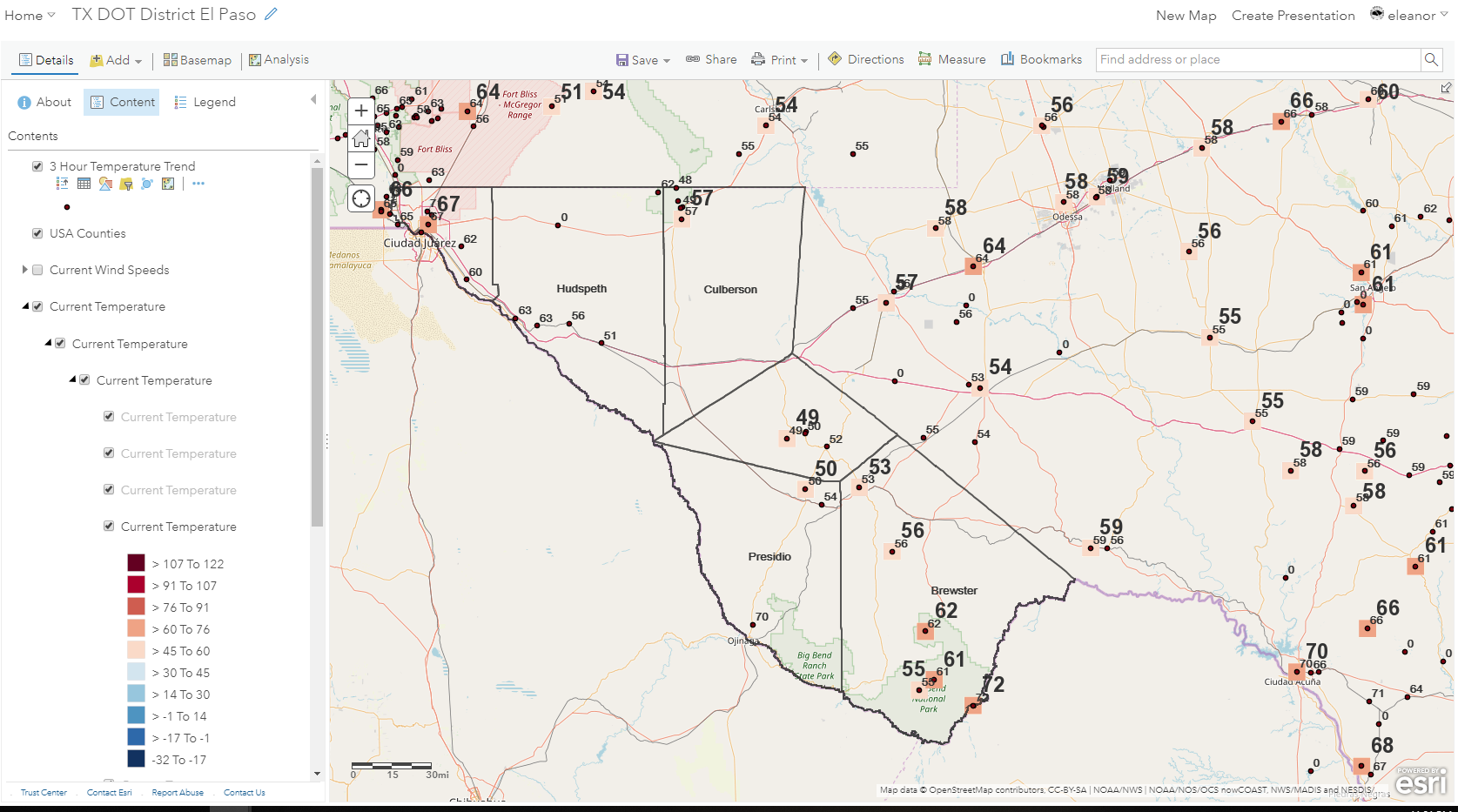

I have created an application with Web Appbuilder and checked it to be shared with the public. However, the URL for the application will not open unless you are signed in to our online acct. can anyone give me some feedback on why it cannot be viewed by the public?
