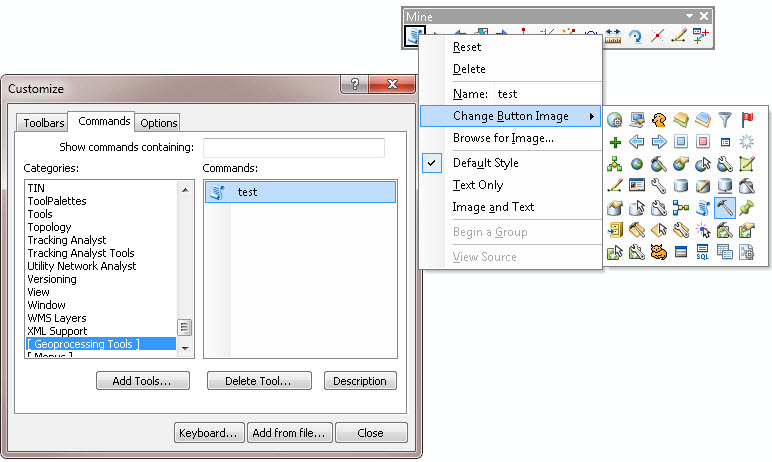

Right-click on a toolbar, go to the bottom and select Customize,
Click the "Commands:" tab

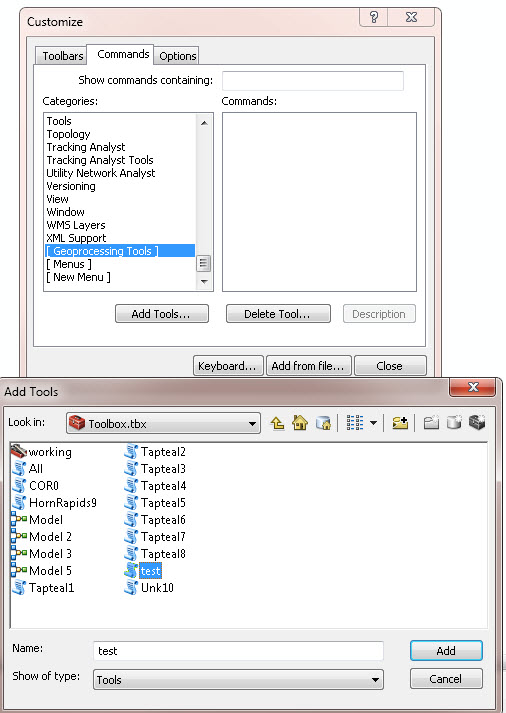

Scroll to the bottom of the Categories and select [ Geoprocessing Tools ]
Click the Add Tools... button
Browse to the toolbox and script tool that you created and select it.
It will now show up in the Commands: window
Drag it to a toolbar, then you can right-click on it, Change Button Image, and select the hammer (or whatever icon you want).
Keep in mind that if you make any changes to the script tool, you will need to remove it from the Geoprocessing tools list and the toolbar, re-import the changes to the tool, then re-add it to the Commands: window and the toolbar or the changes won't take effect.
