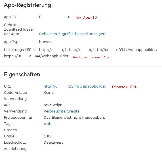

My settings in AGOL/WAB-app panel (german language settings)
