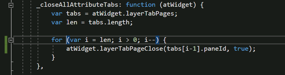

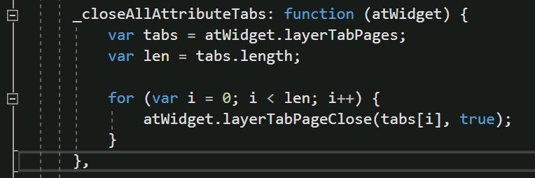

Is there anyway to close and clear all tabs in attribute table widget ? I am using below code to do that but it is not working.
atWidget is reference to attribute table widget.
RogerF
found the solution.
RogerF
found the solution.
