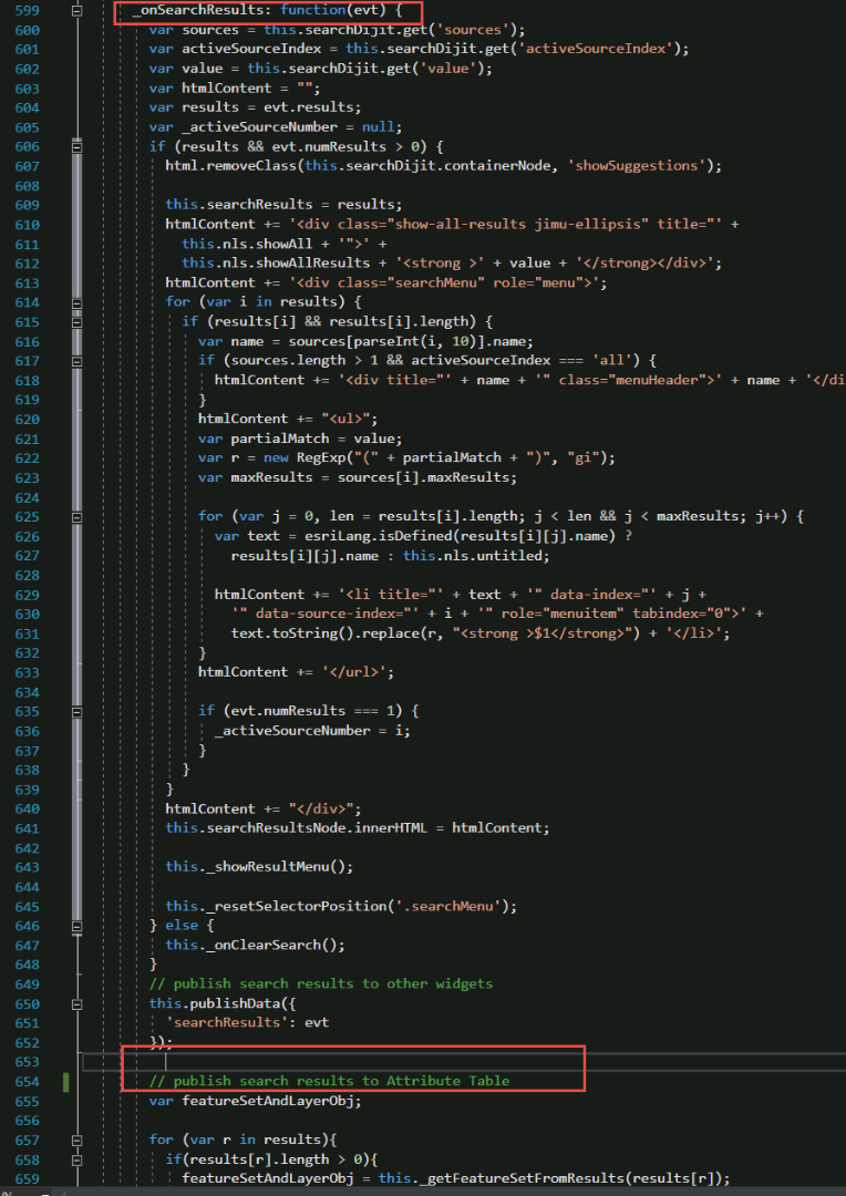

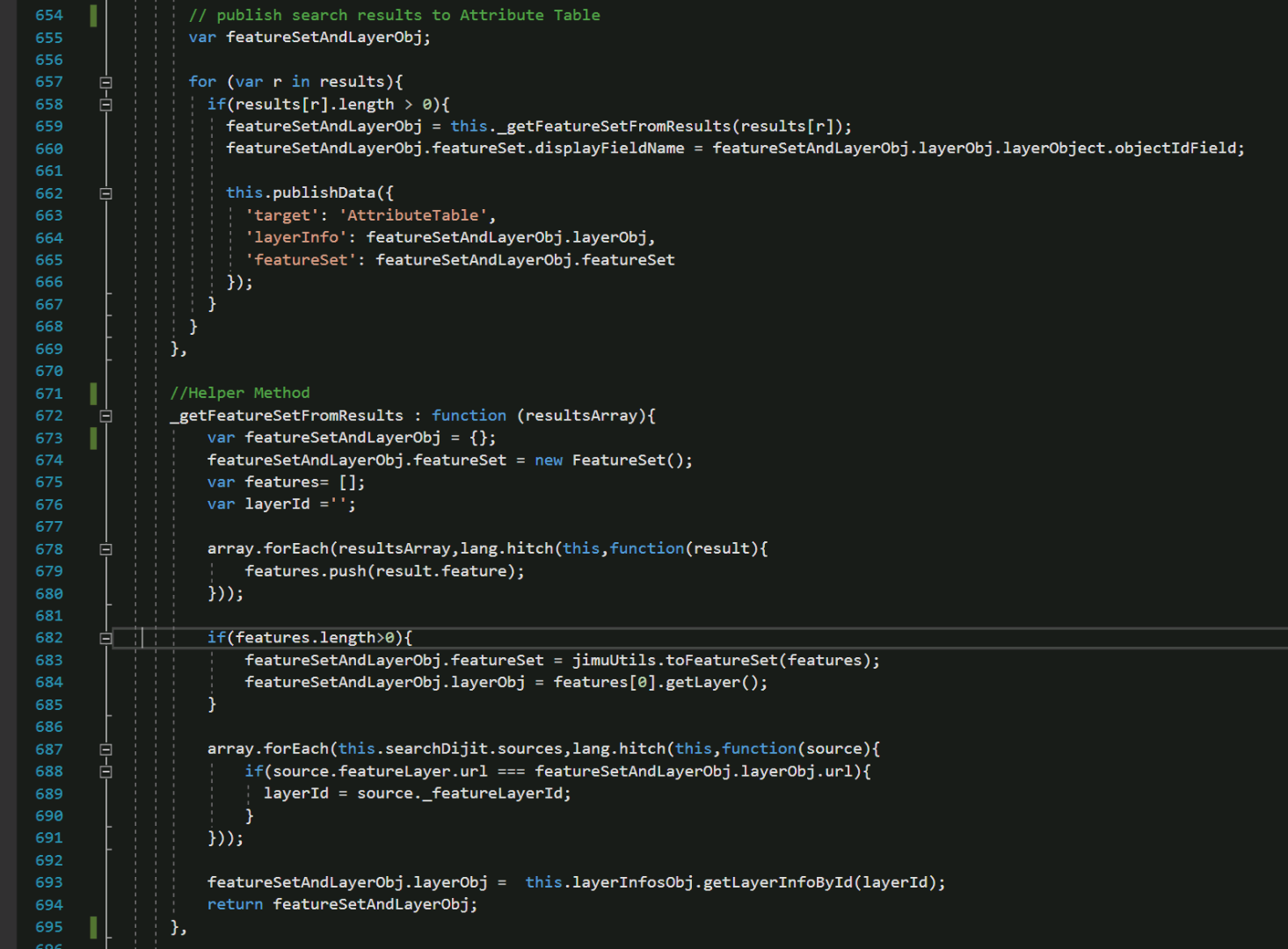

I was able to do that by making following changes in widget.js file of search widget
Now only problem with this approach is, it displays search results in attribute tables after it finishes searching all the layers configured in search widget and it is taking more time (more than 1 minute sometimes) I wanted to check if there is any way to do this sequentially. i.e displaying search results in attribute table layer by layer.

JaysonLindahl
Roger,
I'm running into some issues when trying to get your solution to work.  It looks like it crashes when it gets to the following line item: featureSetAndLayerObj.featureSet = new FeatureSet();
