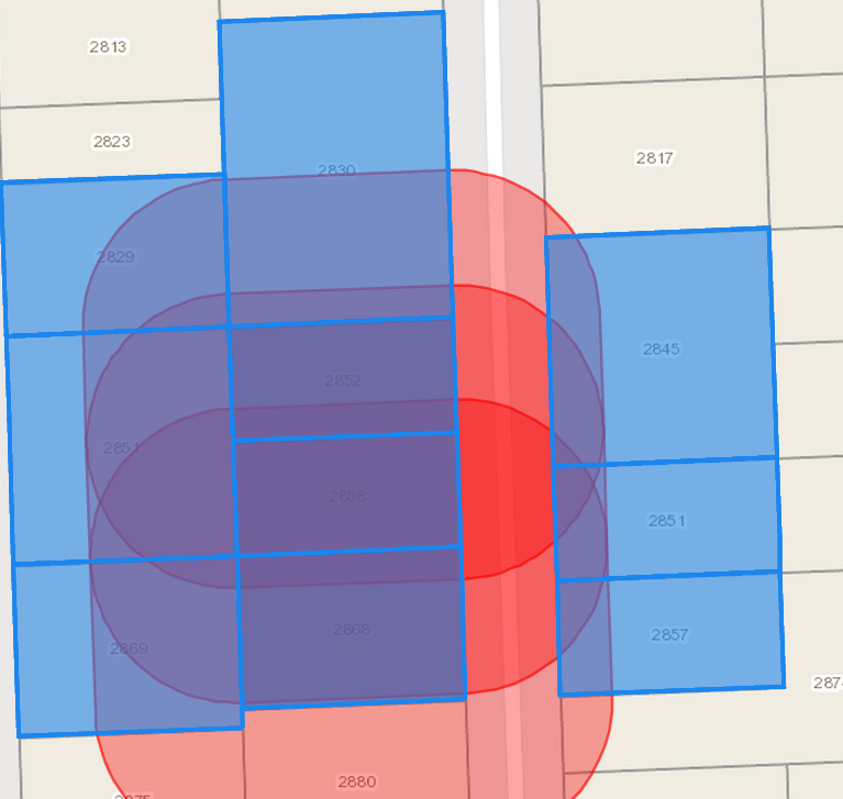

The issue is unionResults seems not working.
2651
9
09-03-2014 11:18 AM
ZhanGao
Deactivated User
Try to develop buffer widget but the issue is unionResults seems not working
var params = new BufferParameters();
params.distances = [dom.byId("distance").value];
params.bufferSpatialReference = new esri.SpatialReference({ wkid: dom.byId("bufferSpatialReference").value });
params.outSpatialReference = this.map.spatialReference;
params.unit = GeometryService[dom.byId("unit").value];
params.unionResults = true;
The buffer cannot be dissolved.

   What kind of error are you getting? Have you simplified your input geometries using GeometryService.simplify before attempting to buffer?
ZhanGao
Deactivated User
Hi, Robert
there is no error, but buffer cannot dissolve.

Hi Zhan,
I suspect the code you posted is within a for loop where you are iterating through your features.
If my suspicion is correct, you are actually hitting three individual buffer requests one for each feature. In this case there is nothing to union, as there is only one buffered geometry for each feature.
You may want to consolidate all your feature geometries within the loop as an array and call buffer from outside the loop.

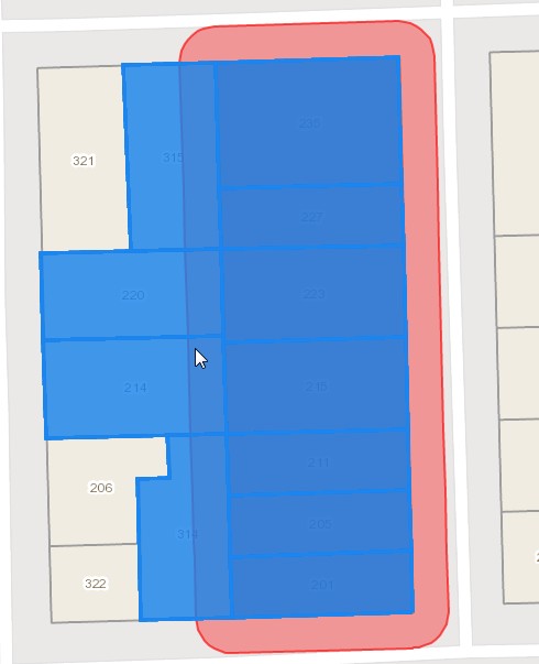

ZhanGao
Deactivated User
Thanks Robert,
I figure out the solution, here the code I add to create polygon.
polygon = new Polygon(this.map.spatialReference);
              for (i = 0; i < graphic._graphicsLayer.graphics.length; i++) {
                  ringsLength = graphic.geometry.rings.length;
                  if (this.map.graphics.graphics.geometry.type == "polygon") {
                      for (j = 0; j < ringsLength; j++) {
                          polygon.addRing(this.map.graphics.graphics.geometry.rings);
              params.geometries = [polygon]
              if (type === "polygon") {
                  //if geometry is a polygon then simplify polygon.  This will make the user drawn polygon topologically correct.
                  gsvc.buffer(params, lang.hitch(this, this._showBuffer),
                        function (err) {
                            alert("Query " + err);
              } else {
                        function (err) {

   Your method is working because to are manually merging the the polygons client side instead of allowing the Server to buffer all the geometries at once and then merge them server side as my code shows. Either way can you mark this thread as answered so that people can find the correct answer. Do this my clicking the "Correct Answer" link (with the little green star) on your reply or mine.
ZhanGao
Deactivated User
Hi Robert,
we need to check if geometry type is polygon then add feature geometry to the array.
if (feature.geometry.type == "polygon") {
                      bufferGeometry.push(feature.geometry)
