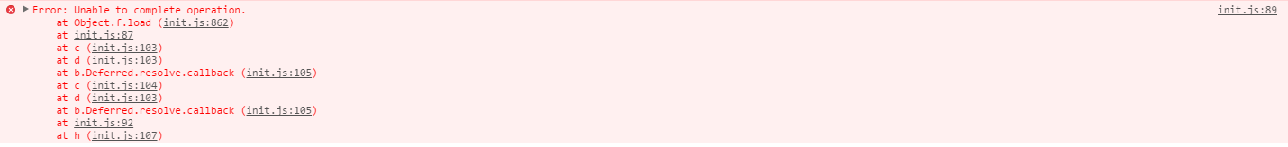

KrishV
Hello Robert Scheitlin, GISP‌,
Please find the screenshot below:
Hence, I have commented below line:
feat.getLayer().applyEdits(null, [feat], null);
Regards,
Krish
RobertScheitlin__GISP
MVP Emeritus
Krish,
   So why do you say that it is now working?

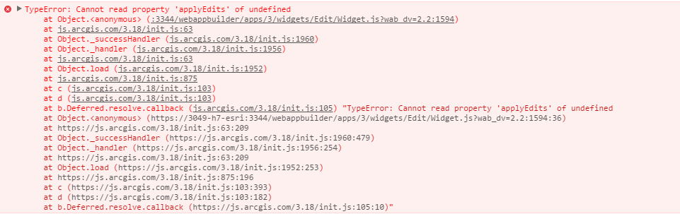

Try:
evt.target.applyEdits(null, [feat], null);
KrishV
Hi Robert Scheitlin, GISP‌,
I said working as It is now working as expected after commenting below line. I'm getting the required name inside the attribute inspector. Hence I marked your answer as correct. feat.getLayer().applyEdits(null, [feat], null);
As suggested by you, I have added below line:
But after adding this line, I'm getting below error. I'm not sure why I'm getting this error:
MVP Emeritus
Krish,
  So is the value saved to the feature if you leave it and come back and select the feature?
KrishV
Just now I have observed that value is not saved.
When trying with this line, evt.target.applyEdits(null, [feat], null);
Please suggest how to proceed.
