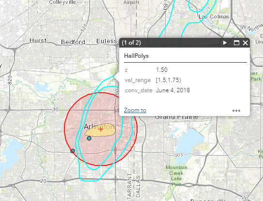

I have a widget that adds a layer from the result of a gpservice. Users can re-run the gp tool for different dates. In doing so the layer is removed and then re-added (with same id) when the new gpresult is returned. The pop ups are acting strange when i do this. As you can see I have these "ghost" features that show the pop up for outlined in blue. The yellow feature in the middle is from the newest gpresult. I can't figure out why it is still requesting the pop up info from the first gpresult.

  are you replacing the layer when the popup is still open? If so that is an issue and you need to hide the map popup or set this.map.infoWindow.setFeatures([]);
BrianLeroux
I think you are on the right track but it is not just that I have a pop up open. Eseesntially if I have a pop up open or have had one open but now closed, I get the same issue. If I never open a pop up on that layer I do not see this issue.

did you try setting the popups feature to null or an empty array?
BrianLeroux
I tried both as well as closing out the pop up window. No luck.

Couldn't get it to work so went a different route. Now just appending a date to the layer names each layer added will be unique.
