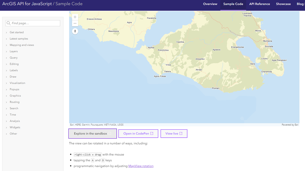

dear Robert,
I want to add or modify the compass code for 2D maps as shown in below script
https://developers.arcgis.com/javascript/latest/sample-code/sandbox/?sample=widgets-compass-2d
Our intention is to provide the rotation of map in our 2D web Maps. Is there already available ready to use widget ? so that i can download and use it in my WAB dev edition?
if possible, where can I set the
view.constraints = { rotationEnabled: true}; "
 https://developers.arcgis.com/javascript/latest/api-reference/esri-views-MapView.html#rotation
please advise and help, thank you,
