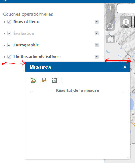

SebastienPelletier
Thank you Robert , this solution works and very easy to do . But there is a gap with the edge of the application because it is impossible to move a form to the edge (see image).
RobertScheitlin__GISP
MVP Emeritus
Sebastien,
  Yep I can not seem to get past that limit either.
SebastienPelletier
I found , you must change all the calls to : "this.makeMoveable " method in the file jimu.js \ OnScreenWidgetPanel.js
and change the value 0.25 to the desired value
