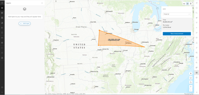

John, I'm assuming you're talking about a widget in AGOL?  I just tried it with the basic measure area tool.  Once I finished the polygon, I was able to adjust the shape by pulling on the existing vertices.  I also managed to add one new vertex, but I'm not sure how.  The measurement adjusts accordingly as I stretch and pull the shape.
Also, I tried the basic measure line tool.  If I added vertices in the original measurement, I could later drag them around too, including the start and end points.

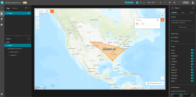

Hi Brynda.  I am sorry, I should have clarified that I am building a web app in Experience Builder and the widgets that come with EB as well as the custom widgets I have seen do not have the features I am looking for.
Also, I went into AGOL (the new Map Viewer) and even that measuring tool does not have the features you mentioned.  Let me know if I am missing something.  Thanks!

I was using the new Map Viewer in AGOL.  If you hover over one of the vertices, it gets bigger and the cursor changes from an arrow to a hand.  Then you can drag the vertex around.  See in the screenshot that the upper vertex is bigger than the rest.
I'll look into the widget in Experience Builder and see if I can come up with an answer for you on that.

The measure widget in Experience Builder appears to work the same way.  I was able to create a shape to measure area, then drag the vertices around to adjust the shape.

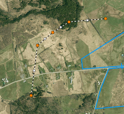

Ah, I see what you are saying BUT the problem is you cannot add or delete vertices to, say, the polygon.  Let me clarify what I am getting at.  In EB, look at the Elevation Profile widget.  With this widget, I can sketch out the path with a polyline (see below).  Notice the small white dots on the line.  The white and orange dots on the line are the vertices I can move with, and I can easily add or remove vertices on the line in order to make more adjustments to the shape.  With the Elevation Profile widget, notice how as you make changes to the path, the profile info in the EP window changes accordingly.
Granted this is an example with a line, which is what I'd like, but I also need similar for a polygon.  I hope I have clarified things.  Thanks!
