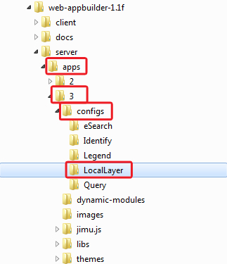

RobertScheitlin__GISP
MVP Emeritus
Lefteris,
   Something is still strange about your install... Here are the steps I follow:
  1. Install the LocalLayer in the appbuilder 1.1 and performed the json modifications and other JS mods per instructions.
  2. Created new app. The LocalLayer widget is visible in the widgets area.
  3. Set LocalLayer widget to visible and click OK on settings dialog (accepting all defaults).
  4. Save the new app
  5. Now configs folder has LocalLayer sub folder with config_Local Layer Widget.json in it.
