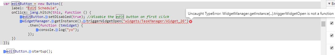

Argghh! Getting the following error:
Why would that be?!

Robert - So close, but I am still getting the same error:
var editButton = new Button({
    label: "Edit Schedule"
editButton.on('click', lang.hitch(this, function () {
    editButton.setDisabled(true); //disable the edit button on first click
    WidgetManager.getInstance().triggerWidgetOpen("widgets/TaskManager/Widget_26")
    .then(lang.hitch(this, function (tmWidget) {
        //now you have a refernce to the Task Manager widget using tmWidget var
editButton.startup();
>>>Uncaught TypeError: WidgetManager.getInstance().triggerWidgetOpen(...) is not a function.
Could this be a scope error or am I using the wrong parameter here ("widgets/TaskManager/Widget_26")?
RobertScheitlin__GISP
MVP Emeritus
Justin,
  It is a issue with the WidgetManager module in your define array most likely. Do you now about matching your module sequence and vars to match?

JustinBridwell2
1.2, I believe. BTW -When I go to the documentation for WidgetManger, there is no `.triggerWidgetOpen' method, only an `.openWidget(widget)` method. In the console when I am debugging, I was able to use
var wm = WidgetManager.getInstance();
var tm = wm.appConfig.widgetPool.widgets[8];
to find the TaskManager widget:
tm
>uri: "widgets/TaskManager/Widget", version: "1.2", id: "widgets/TaskManager/Widget_26", name: "TaskManager", label: "Task Manager", …}
I then tried using this to open the TaskManager widget, but nothing happens:
wm.openWidget(tm);
MVP Emeritus
Justin,
  That would be an extremely old version then as we are at 2.15 in WAB Dev. One easy way to check is open the developer tools and in the console type "wabVersion"
Change your code to wm.openWidget(tm.id);
