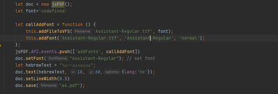

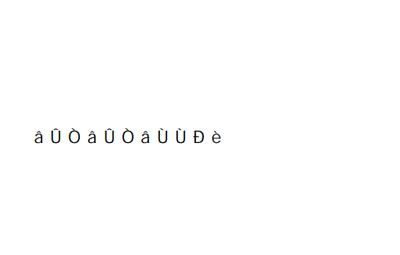

can anybody please help me with this.
I downloaded font.ttf and add the following code:
 the output still doesn't include Hebrew characters, I tried also different fonts but still same:
