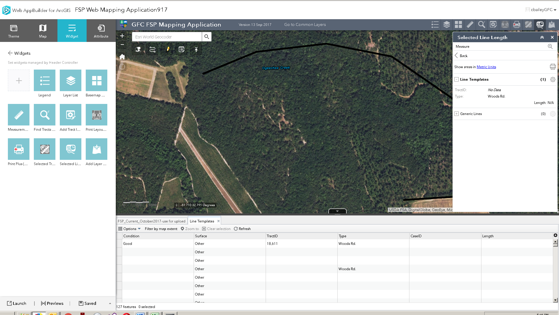

Hello, I'm at my wits end trying to make some 'simple' revisions to the new screening widget in WAB 2.6. All I want to do is remove some of the panels in the widget so that it just allows selecting a layer and outputs the area and length for each selected feature. I don't want the user to be able to buffer, pick selection layers, print, or download and I want to remove the composite AOI area which only includes some of the layers and is confusing and unnecessary. See attached screenshots for further explanation. My ignorance here is quite embarrassing - don't want to say how long I've spent on this... thanks, cob

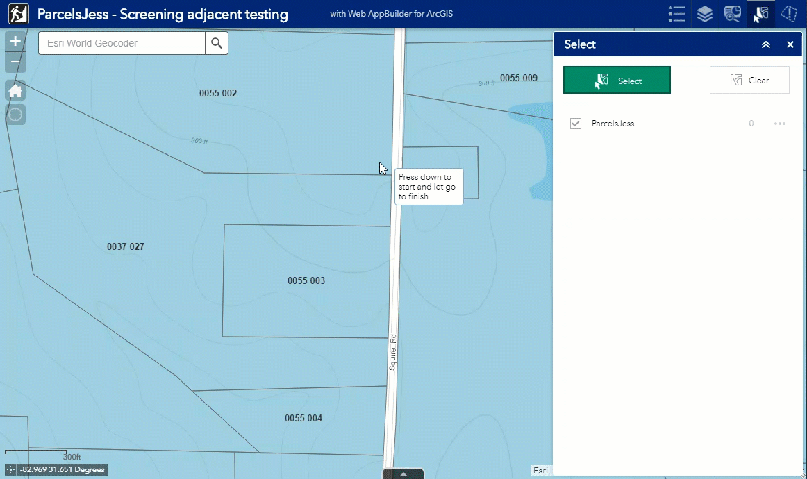

I'm wondering if there's possibly an easier way to address the workflow need you have -- as i understand it, you want users to be able to select features from the map and then get a list of the features that includes the feature area or length?  I've got two ideas for you:
(1) If the area and length of the features is calculated in an attribute on the feature layer, you could do this with the Select widget...
After making a feature selection, click the ellipses and available feature actions will be presented. One of them is View in Attribute Table. This would present a tabular view of the data, including the pre-calculated areas.
Show selection in attribute table

Well it works, and we've actually been using it - for polygons. I can't get it to measure lines unless the line happens to be inside a polygon. It makes the selection on the line features but shows 'N/A" in the length field in the panel. So another setback - unbelievable how difficult it is to measure existing features in the web apps. Who wants to do that, right? Thanks, cob
JessicaNeuner
This could be related to the way in which the line features are identified.  There are essentially two different workflows within the widget --- one that does a clip and one that does a select by location.  If the Select by location workflow is followed (with the released version of the widget this would happen with Point or Line AOIs that do not have a buffer), then the length and area are not reported since the intention is to report the amount (length, area, count) or the features within the defined area.
