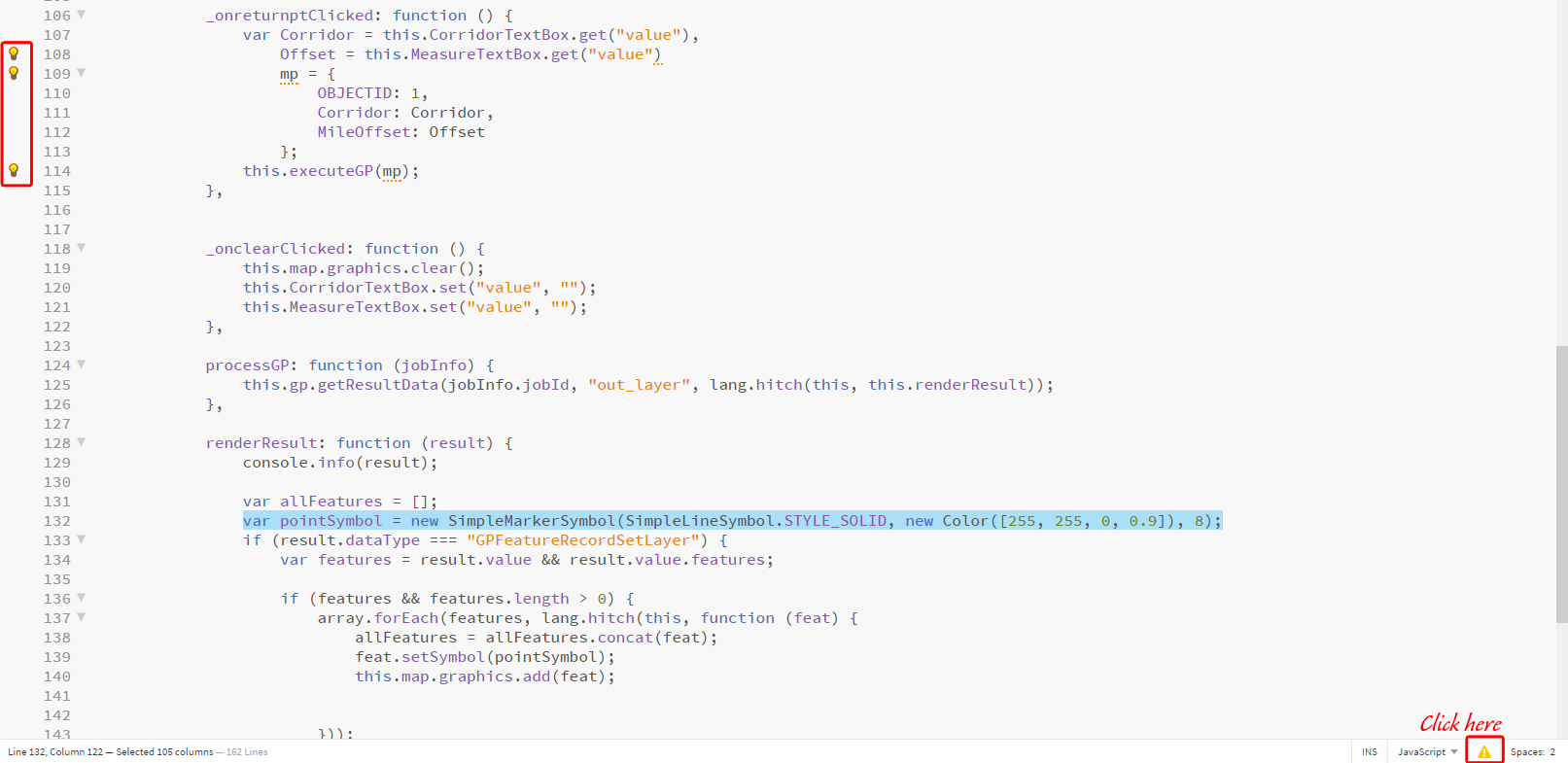

   Is your linter not showing an issue on line 108, 109 and 114? Try adding a comma at the end of 108.

  Click the spot indicated in this image:

Terry,
   If you click where my image says click here then the panel will reappear.
