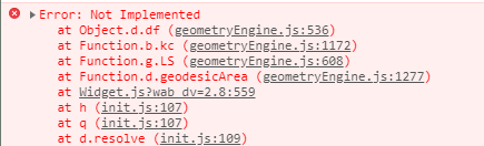

I have this simple code that it displays a graphic. So, geometry is ok. When I attempt to calculate the area of the graphic (line 5)  I get this error. Why? Thanks.
var newbuffer = geometryEngine.difference(buffer,polygongeom);
newbuffer.setSpatialReference(new SpatialReference({ wkid: 102110}));
var buffergraphic = new esri.Graphic(newbuffer, bufferSym);
var thebufferarea= geometryEngine.geodesicArea(geometryEngine.simplify(buffergraphic.geometry), 'acres');
console.log(thebufferarea)
bufferGraphicsLayer.add(buffergraphic);‍‍‍‍‍‍‍‍‍‍‍
this.map.addLayer(bufferGraphicsLayer)‍‍‍‍‍‍‍‍‍
the root of the error is at line 559, which is line 5 above.

Not implemented isn't a bug, it means it has limitations for its use.  It either isn't implemented for graphics or it doesn't like your coordinate system.
For example, the WGS 1984 Web Mercator (Auxiliary Sphere) projection was originally assigned WKID 102100, but was later changed to 3857.
But if is that picky about the renaming, no clue.  The python variant of this is similar
This method only works with WGS-84 (wkid: 4326) and Web Mercator (wkid: 3857) spatial references.
esri/geometry/geometryEngine | API Reference | ArcGIS API for JavaScript 3.26

LefterisKoumis
Thank you! that was it.

  1.   Have you console logged the newbuffer to be sure it is not null?
  2. What is the spatialReference before you set it to 102100?
  3. Did you try setting to 3857 instead of 102100 (this should not make a difference though)?
  4. Have you logged what the result of geometryEngine.simplify(newbuffer)?
LefterisKoumis
Thank you. Changing the Wkid to 3857 made it work!
