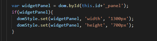

1. You probably can try display multiple graphs in one panel?
If the size of the panel is not enough, try this codes:
