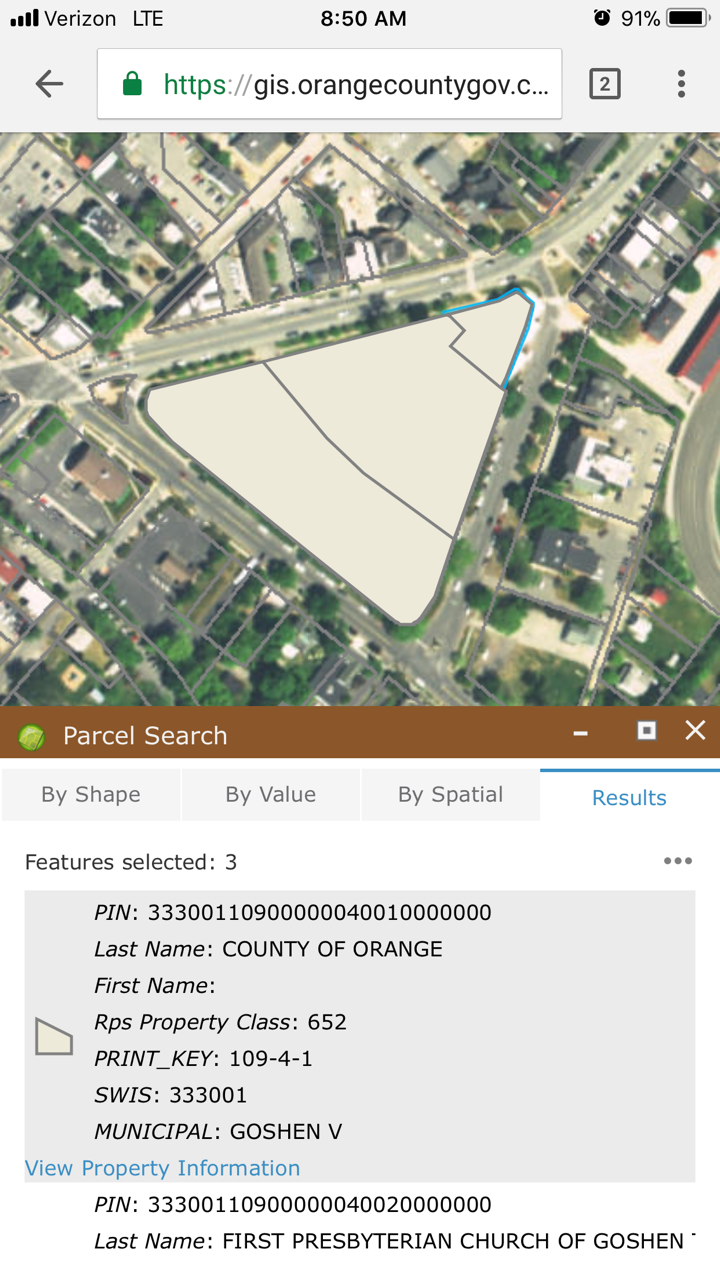

The enhance search widget works great on the desktop browser but I'm not able to make it work on the mobile devices, I'm using the Launchpad Theme, I was able to get a result once using the selection never using the buffer, I tried to get an error report simulating mobile devices with device mode in chrome but it didn't report any errors and performed as designed. Any ideas are most welcome, thank you!

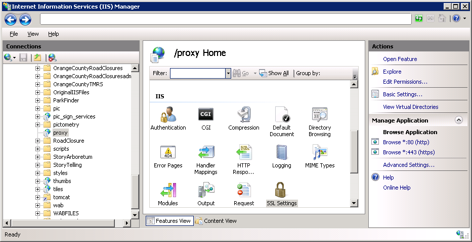

  1. Did you set the proxy folder as an "Application" in IIS?

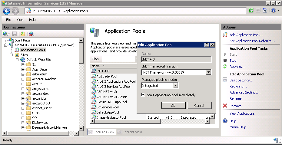

  2. Is the proxy app using .net 4.0 application pool in IIS?

2. image show me that you have an app pool for .net 4.0 but does not tell me that you are using this application pool for your proxy app?
If you right click on the proxy app in IIS and choose "Manage Application" >  Advanced Settings... Does Application Pool say "ASP.Net v4.0"?
