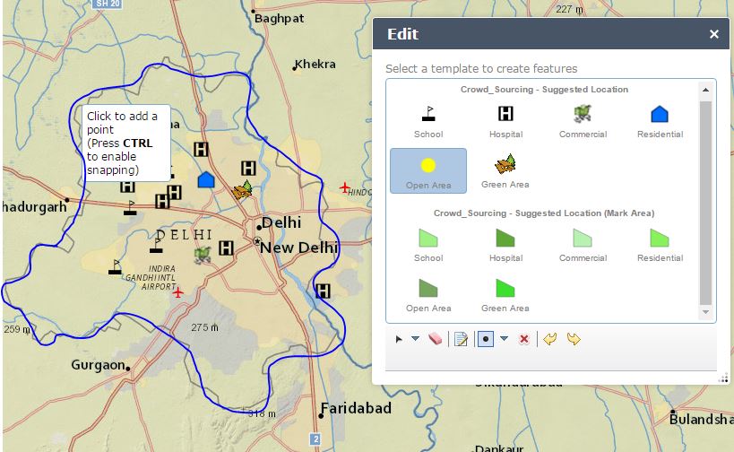

KrishV
Hi Robert Scheitlin, GISP​,
Thanks for your response.
Please find the below screenshot for your reference:
As shown in above screenshot, user should be able to capture only in Area of Interest using Edit Widget.
When user tries to capture in Red Zone, user should get some warning message and shouldn't allow the user to capture in red zone.
Hope my question is clear now.
Please let me know how to achieve this by code or any configuration in Edit Widget. I'm using WAB 1.3.
Your support is much appreciated.!

KrishV
Hi Robert,
Thanks for your time for helping me on this.
I have edited code as suggested and I have observed that Edit Widget is not allowing polygons to be added inside the extent and getting Message "Can Not Add Feature".
For myAlowedExtent, I have used as below..
Example:
new Polygon({"rings": [[[456891.299023729, 3314213.43369951],
       [1106254.84054385, 3330754.54613897],
            [1127994.04876981, 2910647.36018221],
            [455355.318132059, 2895508.2708336],
            [456891.299023729, 3314213.43369951]]], "spatialReference": { "wkid": 102100 }
Please find the below screenshot which shows my AOI highlighted with Blue Color.
First it is allowing to add Point Feature inside the ring but when I'm trying to capture Polygon, I'm getting message "Can Not Add Feature". After this message, I'm unable to add Point Features also. Request you to review and suggest.
Thanks for your Support!!
Regards,
Krish

KrishV
Hi Robert,
Thanks again for your time..
I have done the necessary changes as suggested by you. Now, Edit widget is allowing all types of geometry to be captured but have found two issues:
1. Edit Widget is unable to capture features when I switch from point to polygon and then to point. (After switching from point layer to polygon layer 3 times, Edit widget is unable to capture both point & polygon features).
2. When polygon drawn outside the extent, there is pop up but polygon is not getting deleted.
Request you to review and suggest how to proceed.
Regards,
Krish

KrishV
Hi Robert,
Thanks a Million!!!!!!!
You are Genius..!
Regards,
Krish
