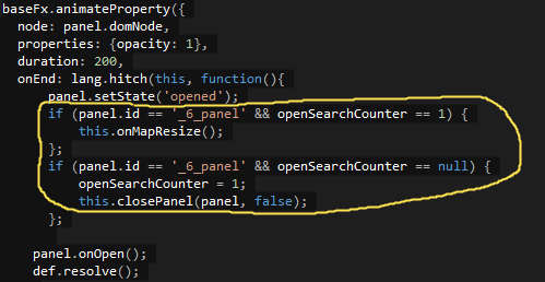

Thanks Robert. My request was confusing, and probably only specific to my needs. I was able to use the PanelManager.js to close the eSearch widget before it displays. That way the URL parameters are available for an external application to open zoomed to a highlighted feature with the table displayed.
Also, users navigating directly to the site won't notice the widget enabling.
