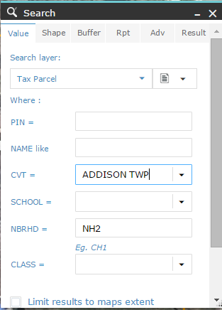

Is there a way to clear the latest eSearch attribute values?  Currently, I go to each control and individually clear it.
I could see good reasons for keeping the values selected, but I'd probably rather they be cleared after each search.  Or maybe cleared when the "Clear" button is pressed.
