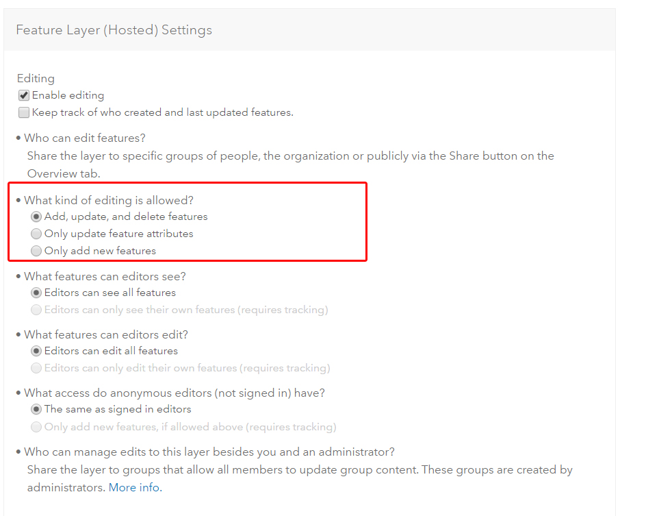

Hi - I am working on customisation of AWAB Edit widget in AGOL. I want to diable the 'Delete' functionality from the widget but users can add the feature. Basically remove the 'Delete' button from the Edit tool popup window. Thanks in advance

   If you are using a hosted Feature Layer on AGOL then you can set the allowed edit properties
Or in the Widget.js update this function (add line 16 - 18):

Thanks Rober -Your advice works for me but I did change at AGS service level as we are not using public AGOL.
