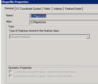

   The use Post part is not important if the shapefile you are using does not work using the esri sample page then there is a bigger issue. Does your shapefile have Z and/or M values?
JamesCrandall
MVP Alum
No z or m values.
