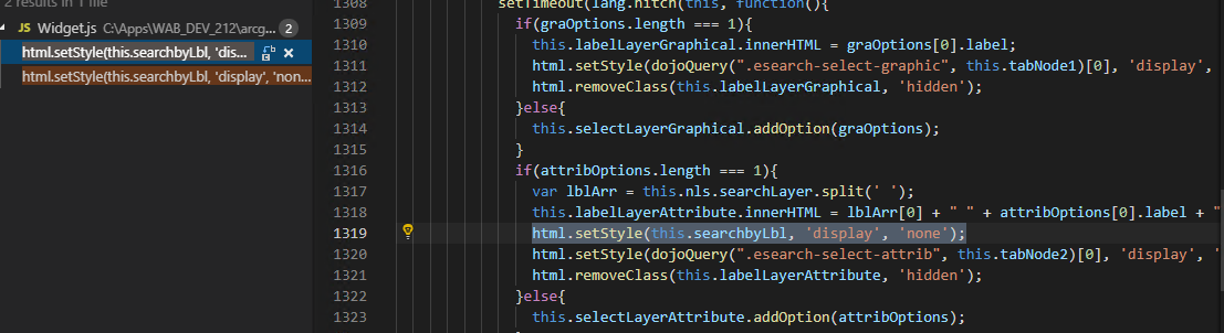

   You must have missed something then. This line:
html.setStyle(this.searchbyLbl, 'display', 'none');
is suppose to hide the "Search layer" in you image above.
It is working for me so I am not sure what is wrong on your end.
JohnWatson_EBA
ok I'll look into it more.  I do have the code correct as you've sent it to me:
RobertScheitlin__GISP
MVP Emeritus
John,
   Did you change both instances are mentioned in my instructions?

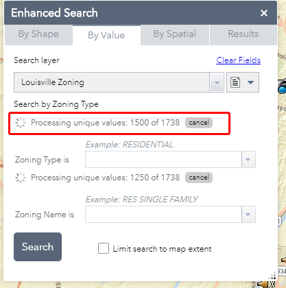

When I do the expression OWN “is” Unique not all the ownership shows
Strange. I have not run into that before. When the widget loads and it displays Processing unique vales x of x
Does the second number equal the total number of records that are in your owner table?

  OK, using the eSearch 2.13 version with your service I get 2 results when I type "steam". So there is one missing. I did quite a bit of tesing and fixed it to return all 3 results and this is the fixed function in the PagingQueryTask.js:

TownOfGroton
Hi Robert,
Thanks for looking into this issues for me.
I upgrade to the newest version (2.13) and add the new code that is above but now the values aren't loading at all. See the site.
ArcGIS Web Application
MVP Emeritus
Jenna,
  Well, I am sorry. I left some testing code in there. You need to delete lines 16 - 18 and 51 - 53. in the code above.
