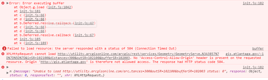

Hi Robert, I'm getting a new error with the eSearch buffer: perhaps I should switch to my own geometry server?

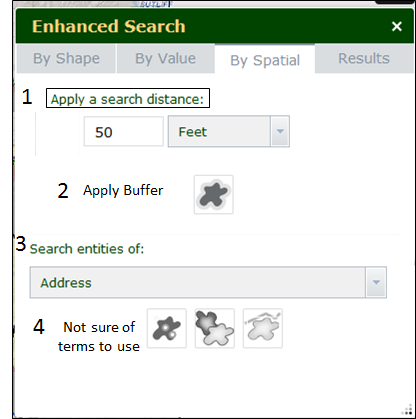

AdamGebhart
Robert Scheitlin, GISP
Is there any chance you can give me some pointers here... and possibly consider a modification to the interface in a future release?
I've received a couple requests from our staff over the last few months to update how the 'By Spatial' tab appears.  They would like to know if it's possible to move the 'Apply Buffer' button below the input buffer distance box.  I think some of the users are mistaking it simply for an image, or just don't know that you enter the distance first, then the button.  In essence, it would look like 'Search entities of' area.  Also, would it be possible add numbers before each item to help give the user an idea of the full progression?  For example:
I have no idea how much work this would entail or if it will mess up something else in your setup but I just want to see if it's possible.  If it's not something you'd want to modify, and if you have tips for how to accomplish it, I'd be glad to try them.

Adam,
  I will look into making the spatial search more user friendly in a future release (for those who refuse to read help docs).
Help - Enhanced Search widget | Spatial Search

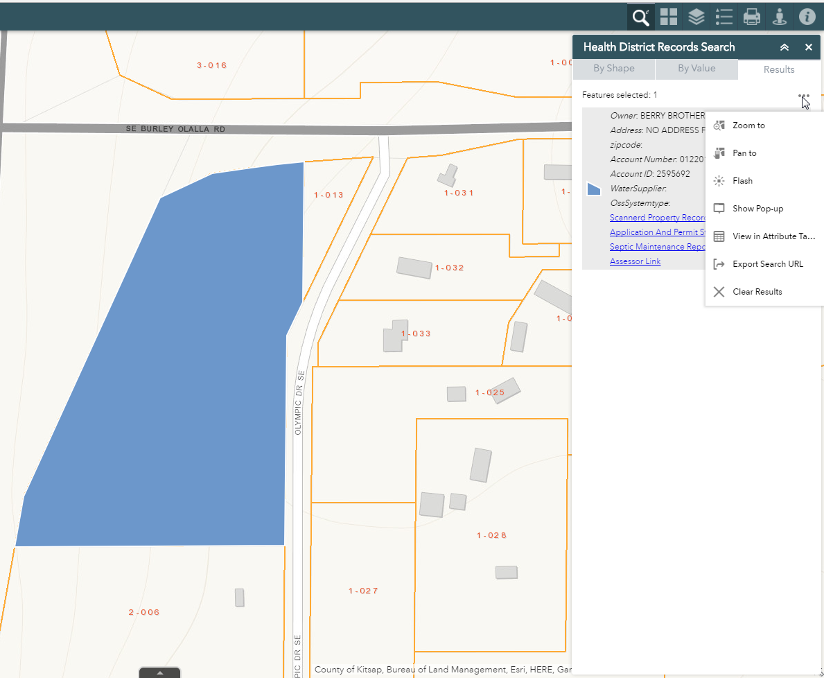

Anish_Adhikari
I am having a minor issue when using Google Chrome with the widget. I am using version 2.3 of the widget and was able to reproduce the issue on 2.4 as well. Basically when I first launch the application and perform a search using chrome and click on the Results menu button after getting search results, some of the menu items look garbled as shown in the picture. If I click on the menu second time, it looks normal. It looks normal for the entire session no matter how many times I use the widget. It reappears when I start a new session or refresh the browser. I am using the latest version of chrome browser. This issue has not appeared in any other browsers. I used Search By Value. It also does not appear when the widget is not a header controller widget.
Here it looks garbled on first click.
Here is looks OK on second click.
RobertScheitlin__GISP
MVP Emeritus
Anish,
   Thanks for reporting this it will be fixed in the next release. You can fix it now by adding this css rule to the eSearch/css/style.css file:
.popup-menu .popup-menu-item .label {
  display: block;
Anish_Adhikari
 Robert,
Thanks for the speedy reply. The garbled problem has been solved with the new css rule. However, It is cutting off the last few characters of View in Attribute Table menu item. See screenshot below.
MVP Emeritus
Correct the real problem is in the popup menu class that is out of the control of my widget (WAB core). It seems that it is not calculating the menus width properly the first time it is shown but subsequent shows do calculate correctly.

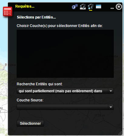

AmalHorchi
Hi Robert ,
Please is there any widget in javascript  that replaces the query generator widget  in flex ?
MVP Emeritus
Nope. No one has developed that one so far.
AmalHorchi
Thanks Robert so much .

Anish_Adhikari
Hi Robert,
I was wondering if it is possible to disable displaying the Search Layer dropdown arrow button and dropdown menu when there is only one search layer configured in the eSearch widget, Basically it would be helpful for our end users if they could just see the static box with the search layer name faded without the dropdown menu just like the font style used in the "Tax ID is" heading. Thank You.
