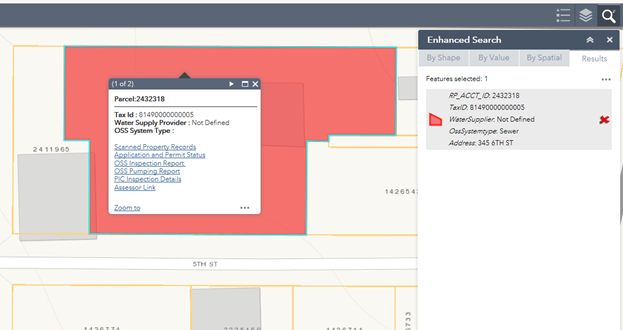

Hi Robert,
Thank You so much for such a powerful widget. I have been been experimenting with it and I am having some issues with the widget.
Issue #1 - Show popups from webmap setting: I have a parcel layer which uses custom formatting in the webmap popup. I have custom formatted it so that it passes parcel id or account number as values to different web services and it works well in the webmap as well as when through app created using web appbuilder developer edition. However, when I enable this in esearch, it is giving me incomplete results. For example look at the screenshot below which is the default popup configured in webmap.
Correct Popup (Configured in Webmap) :
Incorrect Popup (Returned by esearch when show popups from webmap is used):
            Notice that in the screenshot below, the popup is not showing a value for OssSystem type(Should be sewer) even though it is showing on the eSearch results and default webmap popup(See above)
            Also the esearch returned popup is cutting off some url parameters.
Example: The url Assessor Link is showing:
https://psearch.kitsapgov.com/webappa/index.html?parcelID=
Instead of
https://psearch.kitsapgov.com/webappa/index.html?parcelID=81490000000005

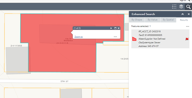

Issue # 2 - Blank Popup Window : When Disable Search results pop-up is checked either globally or on individual Search configuration, when you perform a search and click on result on the map, it will show a blank popup panel window.
Blank Popup Window when using Disable Search Results
Issue # 2 seems to go away when you check Add Result as Operational Layer setting on the configuration settings.

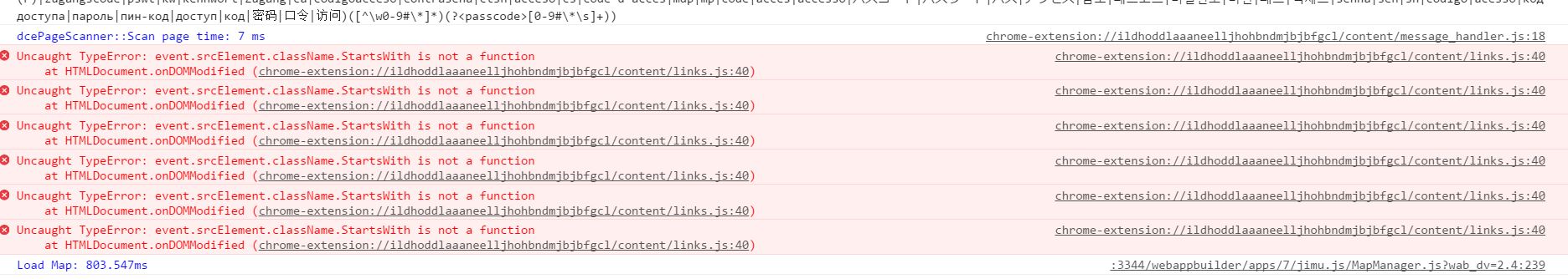

I've also ran into issues when using custom webmap popups with the Use Popup From: Web Map option in eSearch.  Except with mine, the search just fails without any response in the app.  This error is thrown in the console:
Uncaught TypeError: Cannot read property '_fieldLabels' of undefined
 at Object.<anonymous> (Widget.js?wab_dv=2.1:1494)
 at Object.forEach (init.js:70)
 at Object._createSearchResultLayer (Widget.js?wab_dv=2.1:1480)
 at Object.search (Widget.js?wab_dv=2.1:2107)
 at Object.<anonymous> (Widget.js?wab_dv=2.1:1773)
 at Object.<anonymous> (init.js:63)
 at Object.c [as onDrawEnd] (init.js:119)
 at Object._onDrawEnd (DrawBox.js?wab_dv=2.1:471)
 at Object.<anonymous> (init.js:644)‍‍‍‍‍‍‍‍‍‍‍

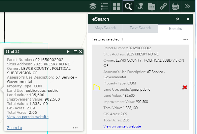

In my case, I could create popups in eSearch that were almost identical to what I had created in the web map, so I just went that route.

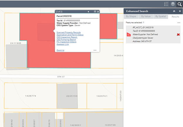

Anish_Adhikari
Hi Ryan, Thank You for your reply. I found out at least part of the issue for my problem. It seems like web map is forgiving as far as case sensitivity on variable names such as TaxID is same as taxid. On the other hand, looks like eSearch is not. so when I had a parameter name taxid which is actually named TaxID on the Service definition, it gives you unexpected results. Changing the name to the correct case as the service definition seemed to solve the problem.
RobertScheitlin__GISP
MVP Emeritus
Anish,
   So which issue did that fix?

Anish,
   OK I got your #2 issue fixed for the 2.3 release.
RyanKelso
Yes Robert it uses some fields.
eSearch results and popup:
Web map popup:
So you can see the popups are almost identical, I just gave my web map popup a title of "Parcels:".  So this is not a big deal for me.  I just mentioned it in case it was somehow related to the problem Anish was having.
Anish_Adhikari
Thanks Robert !!
Issue #1 is fixed by changing the variable name. I just tested it. I am looking forward to your next release.

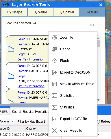

RichBell
Robert,
I am seeing 2 "Statistics" when using the eSearch widget 2.3.
Any ideas on how to remove one?
Rich
Statistics
MVP Emeritus
Rich,
  Strange I am not seeing that on the live Preview site and I can't seem to duplicate that in my development environment either.
