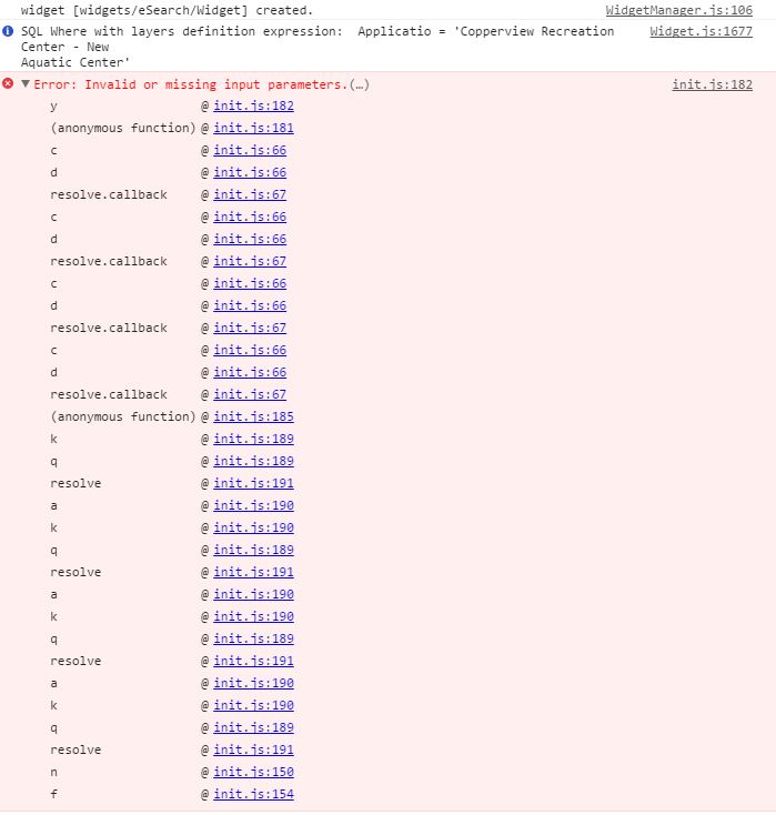

I have had my eSearch configured for some time now. Today one of the users at my organization told me it was not working properly. I got on and ran it and got the following:
When I ran the console in Chrome, this is the error I received:
Any ideas on what could be causing this issue? I'm pretty clueless troubleshooting this widget.
RobertScheitlin__GISP
MVP Emeritus
Jordan,
  It looks to me like you have changed the schema (available fields or the like) for one or more of the search layers configured in your eSearch. Can you remember changing field names or schema on any layer recently?

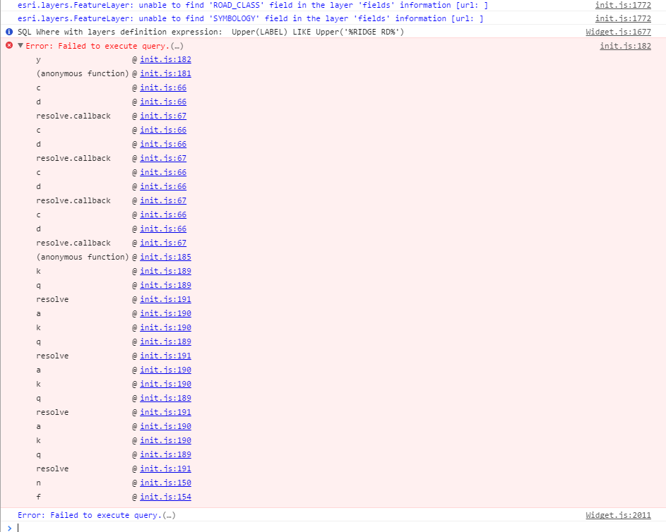

Hi Robert,
I have a problem to configure eSearch, after installing the widget either on Web Appbuilder, simple or developer, I cannot add or modify layers , when I click on Click Add a Search Layer, I get a blank and non-editable field! no new search dialog opens (see picture 1)
on the interface of the map I get the error "create widget error: Widgets / eSearch / Widget" when I click eSearch (see picture 2).

Karim,
  Are you using WAB 2.0?  I have not certified eSearch widget for WAB 2.0 yet. Normally you should always keep version numbers the same (i.e. eSearch 1.3.0.2 works for WAB 1.3).

  Can you show a screenshot of the error in your web browsers console?
KRouissi
Yes of course, the screenshots are taken on browser Firefox 45.0.1 with the web console :
The first screenshot when i launch interface : http://hpics.li/44d0119
the second when I click on add a layer : http://hpics.li/0ba2bdd
and the third when I click to change a layer, an existing layer (Tax Sales)   : http://hpics.li/b26847d
MVP Emeritus
Karim,
  It looks like a French locale issue in the widget. I will have to look into this.

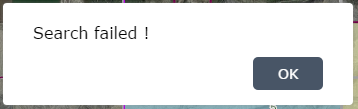

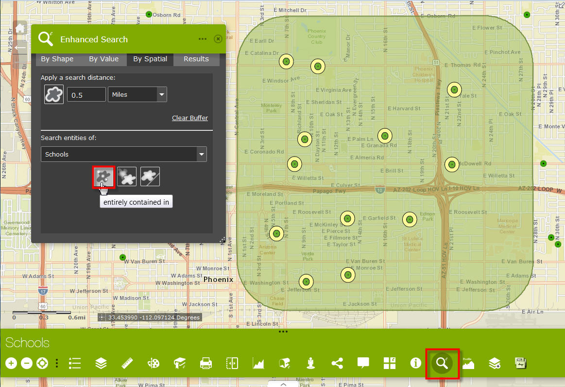

"By Spatial" tab fails.
This was working previously, but I'm not certain what has changed or if I've set something incorrectly.  I have 2 services configured on this eSearch widget where I'd like the user to be able to perform an attribute/value search on 1 of the service layers, create a buffer around that selected feature and then "Search entities of": the other/2nd service layer -- making a selection from the buffer.
It doesn't error, but it does fail to make the second selection (sort of).  It simply selects the features of the 1st service layer intersecting the buffer!  Here's the workflow and result:
1. Perform ByValue search on service #1.  Success.
2. On BySpatial tab, Apply a search distance of 2 miles and create buffer.  Success.
3. On BySpatial tab, Search entities of a different service #2, intersected by the Buffer Graphics.  No error. but...
4. The selection is performed on service #1, removing the selection from step 1. and creating the selection.
So, yes it works but it works incorrectly.
Any ideas?
Thanks!
MVP Emeritus
James,
This is a bug and here is the simple fix. In the Widget.js file search for "this.selectLayerSpatial.addOption(spatialOptions);"
and add these three lines right below that line:
if(spatialOptions.length > 0){
  this.spatialLayerIndex = spatialOptions[0].value;

DAVIDDAS1
Robert,
I never knew that you could enter a negative buffer distance, which leads your brilliant solution.
I learned something new today!
The negative buffer feature opens up so many new possibilities while doing spatial analysis.
