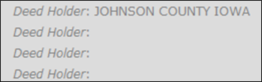

AdamGebhart
Hi Robert Scheitlin, GISP​.  Again, thanks for sharing and updating all of your widgets.  Can you please answer my questions below?  Sorry if these have already been covered in some way.  I am using 1.3.0 or 1.3.0.1 and didn't find anything on the list of 1.3.0.2 updates pertaining to them.
1) For my parcel number search results I want to display four deed holder fields (deedholder1, deedholder2, ...3, ...4) all as the same alias of "Deed Holder."  Are you aware of this being a problem or would you advise against it?  When I execute the search the results window matches what I want, as does the Attribute Table display.  However, when I export to CSV the deed holder field values all take on the value from the last instance of the alias "Deed Holder."  For example, if deedholder1 = "Smith, Joe", and deedholder2 through 4 are blank/null, then all values for the "Deed Holder" columns are blank/null, assuming I have the results setup to show the deedholder fields in ascending order.  See images below.
eSearch results (deedholder1 field = Johnson County, deedholder2 through 4 = null/blank) is correct
Attribute Table display is correct
Export to CSV (column I should = "JOHNSON COUNTY IOWA" but in this case is replaced by the last instance of Deed Holder, or column L) is not correct
Could this be a problem with the Attribute Table widget?  My easy work-around is simply to give them different aliases, but ideally I would like to have them be the same.
2) Is there a setting that will enable the eSearch field results order to carry over to the Attribute table?  As of now mine do not match and I'd like to have the same order in both.
3) It was brought to my attention that when creating a buffer and clicking another layer (other than the first/default layer) in the "Search entities of" dropdown (By Spatial tab) the results displayed in the Attribute Table are those from the first item/default search layer in the eSearch widget.  Should the user be able to pick any item from the dropdown and have its attributes appear there?  Can I configure that?  I want to say this worked in older versions of eSearch but can't remember for sure.  I know it wasn't reported to me until recently though.
RobertScheitlin__GISP
MVP Emeritus
Adam,
  Unfortunately both #1 and 2 are Attribute Table Widget issues
#3 is a bug and here is the simple fix. In the Widget.js file search for "this.selectLayerSpatial.addOption(spatialOptions);"
and add these three lines right below that line:
if(spatialOptions.length > 0){
  this.spatialLayerIndex = spatialOptions[0].value;
AdamGebhart
Robert,
Thanks for the information #1 & 2.  As for #3, I tried on a deployed application and one in WAB 1.3 with eSearch 1.3.0.1 and couldn't get it to work.  I did notice there are two instances of "this.selectLayerSpatial.addOption(spatialOptions);" in widget.js, with one around line 852 and another around line 889.  Should it go under both or just one?  Did I miss another spot?
Just so we are clear on what I'm trying to accomplish... I want to create a buffer, then be able to select any one of my search layers in the "Search entities of" dropdown list on the By Spatial tab and see the features from that layer that are intersected by, intersected by an envelope of, etc.  I don't want it to be restricted to the first/default item in that list.
MVP Emeritus
Adam,
   Sorry I forgot you said you were using 1.3.0... The code fix I provided was for 1.3.0.2. I am not sure what it would be for 1.3.0.
AdamGebhart
Ok.  I'll move up to 1.3.0.2.  Much like 1.3.0.1 though there are two instances of "this.selectLayerSpatial.addOption(spatialOptions);" in widget.js of 1.3.0.2, at lines 882 & 922.  Should Under which line should I add that code?
MVP Emeritus
the 882 one.
AdamGebhart
Thank you for all of the help.
