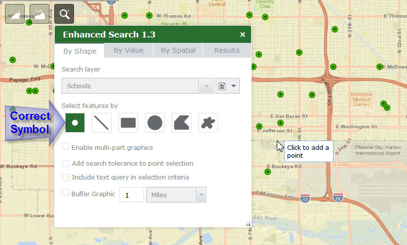

MichaelPotter1
Any thoughts as to why my default point symbol is not showing up properly in the results window and on the map? It should be the binoculars but it is showing as below.
I have the i_search.png file located in the widgets\eSearch\images folder.
Regards,
Michael
RobertScheitlin__GISP
MVP Emeritus
Michael,
   Look in your [install dir]/server/apps/[app #]/configs/config_Enhanced Search.json at the bottom of the file you will find the symbols object and it should look like this
"symbols": {
    "simplemarkersymbol": null,
    "picturemarkersymbol": {
      "url": "images/i_search.png",
      "height": "20",
      "width": "20",
      "type": "esriPMS",
      "angle": "0"
    "simplelinesymbol": {
      "type": "esriSLS",
      "style": "esriSLSSolid",
      "color": [
        255,
        0,
        0,
        204
      "width": 2
MichaelPotter1
Interesting...mine was "widgets/eSearch/images/i_search.png", which is the proper path.
I changed it to just "images/i_search.png" and it worked.
As always, thanks for help Robert!
Regards,
Michael

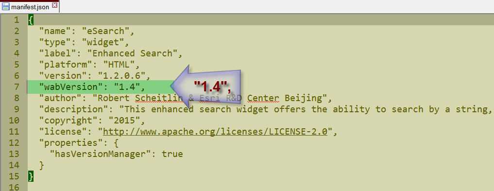

Before adding the Custom Widgets, I edited the manifest.json file of each widget and changed the wabVersion to 1.4

DAVIDDAS1
Hi Robert,
There are several new Widgets in WAB 1.3
When I try to add your Enhanced Search Widget 1.2.0.6
I get this Loading GIF and nothing happens.
I get the same Loading GIF when I try to add your Identify Widget 1.2.0.4
The remaining Custom Widgets all loaded fine.

Make sure you edit the manifest.json file in each custom widget to read:
"wabVersion": "1.4",

I found one minor issue when you open the By Shape Tab for the first time.
The Select by Point Tool shows the wrong symbol.
However, the moment you click on this Select by Point Tool, you get back the correct symbol.
This behavior shows up on all themes.
