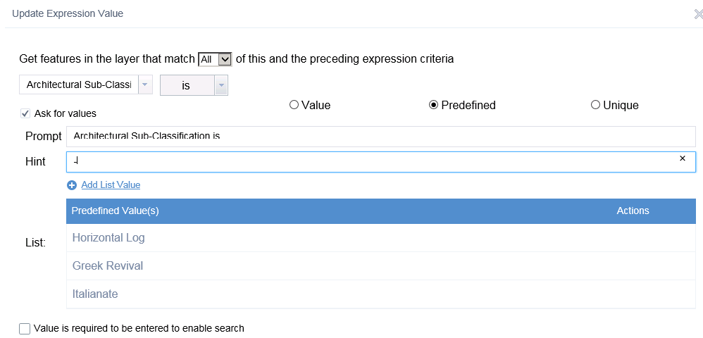

   Here is a image to try an explain better:

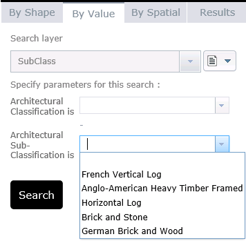

Thank you for the quick response. I just have one more question, relating to subtypes this time.
I have a feature class using Architectural Classification as a sub-type field. Each Architecture Class then has a sub-classification field, with a unique domain for each.
When I try to set up the search for the sub-classification field, its domain always comes back as that of the default subtype (both in formatting screen and on the user end). To remedy this, I attempted to create a Predefined list of all of the values of the sub-classifcation domains. This appears to work fine in the formatting of the widget, but upon trying the use the widget it seems that it is still being overrided by the default subtype domain.
I hope that made sense. If not I can use pictures to help show what I'm talking about.
Thank you again!

I'll tell you why, Robert Scheitlin, GISP​... it's because the field LOOKS like it is supposed to have something put in there. I've been doing this exact thing. Until today.
What I would recommend is in the part of the Widget where you wrote "Such as NAME like 'Roberts'" that you instead put 'Treat This Like A Definition Expression In An MXD' or something similar.

Jacob,
   I am not sure I have tested your exact scenario. Is your map service public?
It really makes no sense that you have tried to configure the widget using predefined field values and when you use the widget it returns to the default sub type dropdown. I have not seen this.

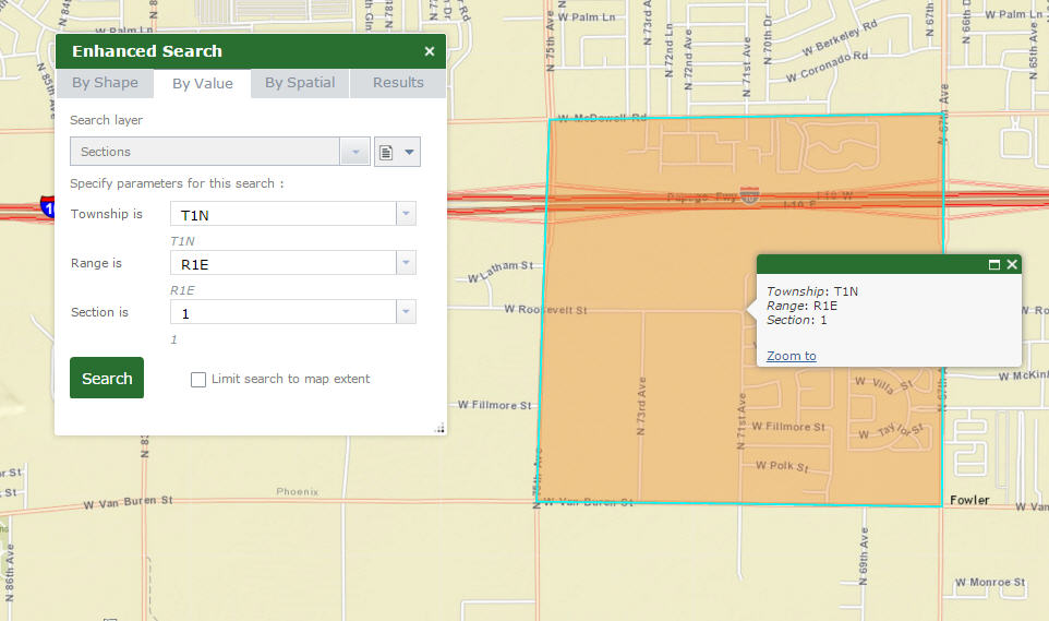

DAVIDDAS1
Hi Robert,
Your Enhanced Search Widget 1.2.0.5 offers tremendous flexibility on how you can construct complex SQL queries by chaining together values from multiple items using the AND/OR operators.
The most common example is to locate a specific Section from a specific Township and specific Range.
http://www.tapasdas.com/Maps/Phones/app83/

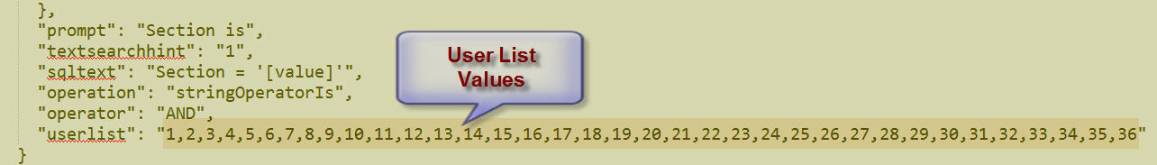

The user can select from the 3 drop down User List values for Township, Range, and Section and easily locate the feature.
It is very easy to enter the User List values by editing the config_Enhanced Search.json file.
I can even add a null value in the User List by entering a comma at the beginning like so.
"userlist": ", 1,2,3,
This gives me the option to exclude the clause from the final SQL statement.
Everything works perfectly when I directly doctor this json file.
I had just one minor request.
When there are many items in the User List, I cannot get to the bottom of the page.
Would it be possible to include a scroll bar in the user interface?

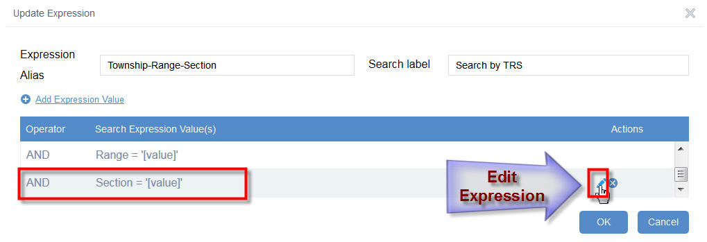

Edit Expression for Section:
This is where it gets tricky to go to the bottom of the page.
I can see values from 1 through 10.
Without a scroll bar I cannot see the remaining values from 11 through 36.
Again, this is a minor issue. I can always doctor the config_Enhanced Search.json file and have it configured exactly the way I want.

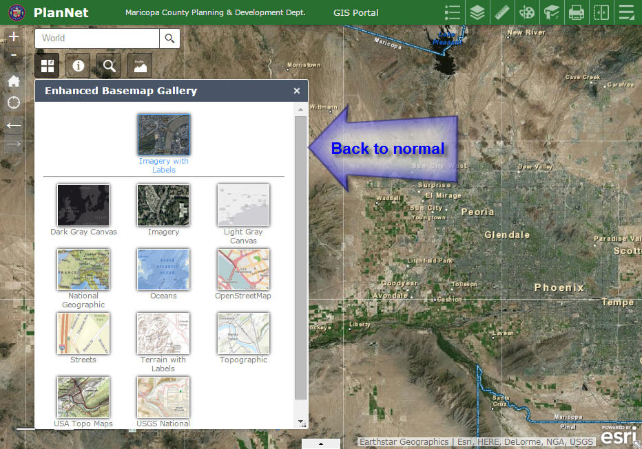

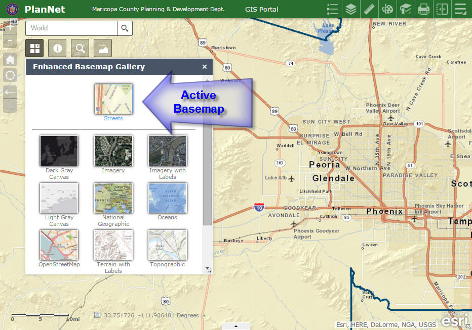

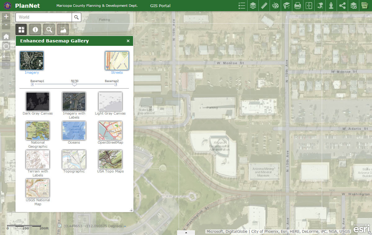

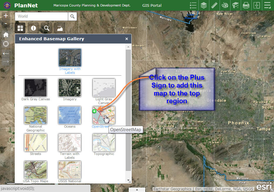

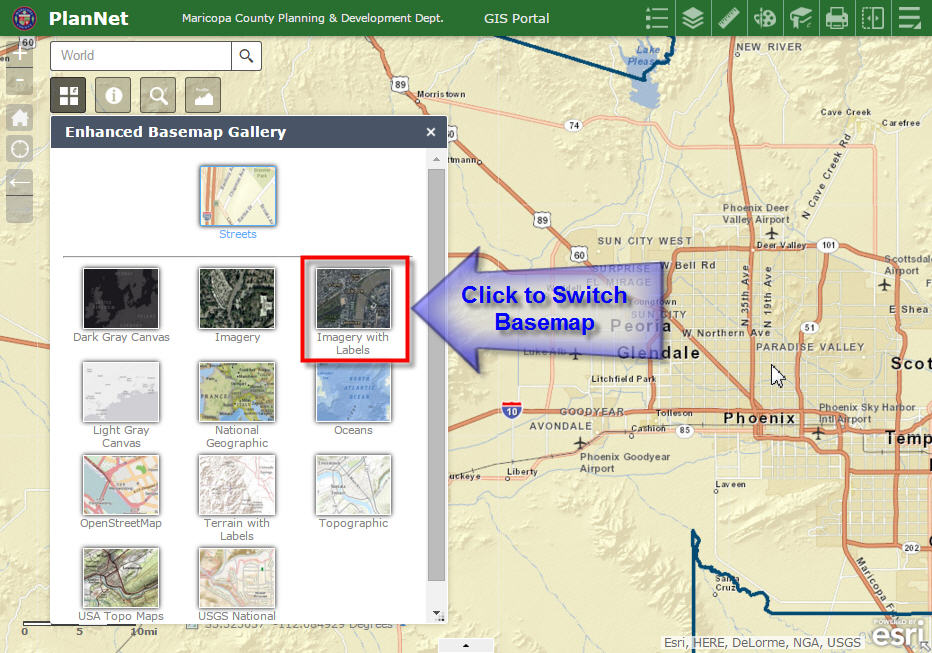

DAVIDDAS1
Hi Robert,
I love the slick new interface you have introduce to the Enhanced Basemap Gallery at version 1.2.0.1
I like how you have visually divided the panel into 2 regions.
The active basemap is always shown on the top.
The remaining basemaps are shown in the bottom.
http://www.tapasdas.com/Maps/Phones/app90/
You can click on any basemap in the bottom region to select it.
The selected basemap now moves to the top and becomes the new active basemap.
When you hover over a basemap in the bottom region, a Plus Sign appears.
Clicking on the Plus Sign adds this to the top region and creates a mashup.
You can fade between the two basemaps.
Clicking on the red X on any basemap on the top region removes it from the mashup.
This takes you back to normal use.
This implementation is so simple, clean, and intuitive, that it does not need any help text.
I came across a minor issue with the GUI when you first add the Enhanced Basemap Widget.
The Configure Enhanced Basemap Gallery window comes up empty!
I was expecting to see the standard ESRI Basemap Gallery icons.
It is possible to click on the Add a New Basemap Button.
It brings up the Add Basemap Window.
I can enter:
Title = 2014 Aerials
URL = http://gis.mcassessor.maricopa.gov/ArcGIS/rest/services/Aerials2014/MapServer
However, nothing happens when I click on the image.
I can always edit the config_Enhanced Search.json file and enter the relative path to the thumbnail image file like so:
"thumbnailUrl": "images/2014_Aerials.jpg",
Everything works fine when I manually copy 2014_Aerials.jpg to the images folder under eBasemapGallery.
\server\apps\APP#\widgets\eBasemapGallery\images\

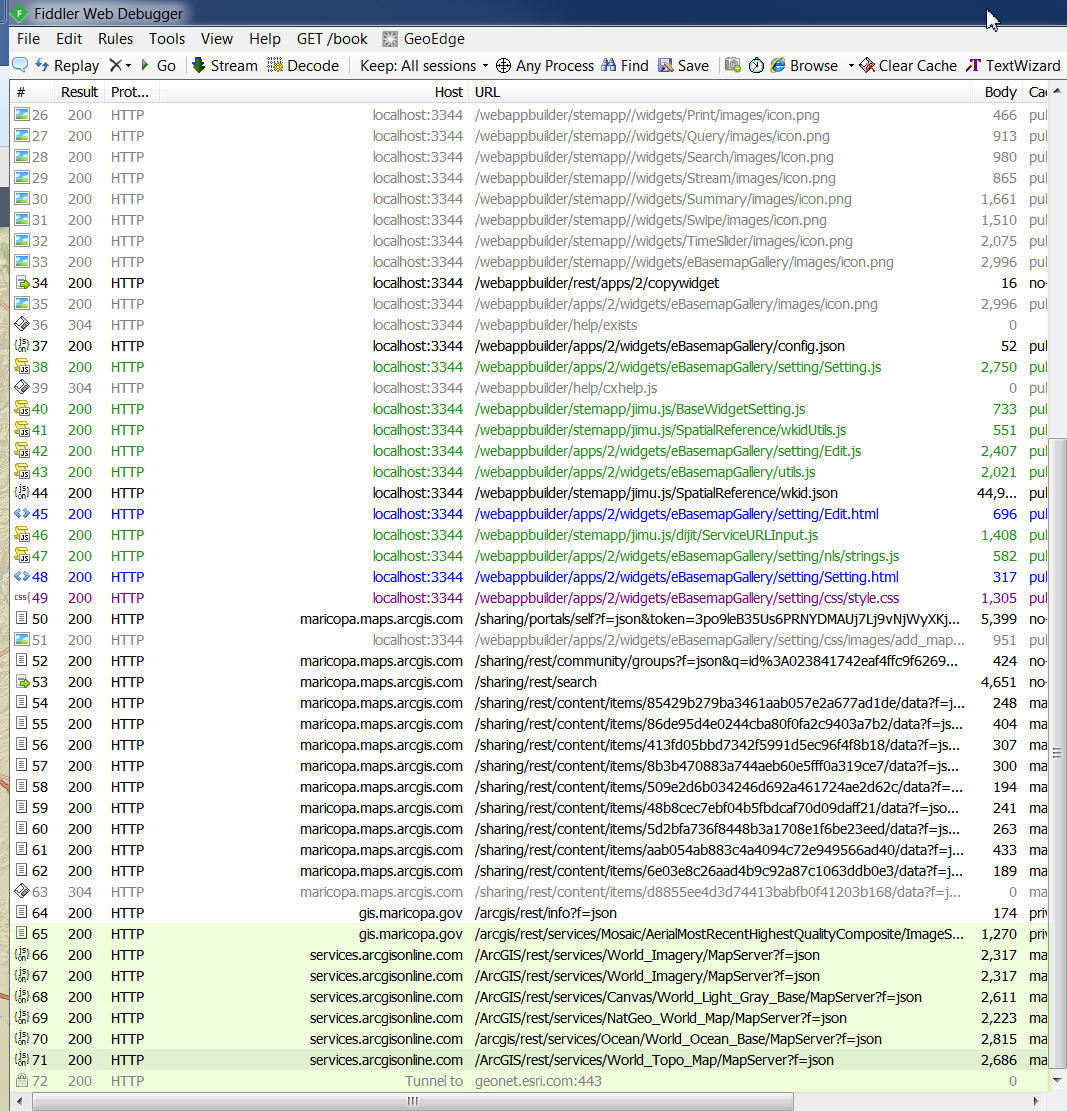

DAVIDDAS1
Hi Robert,
I decided to start from scratch by just adding your eBasemapGallery:
Create a New App using the Default 2D theme
Add an In-Panel Widget
Select Enhanced Basemap
The Configure Enhanced Gallery comes up empty.
Screenshot from Fidder.
Request/Response Headers
Screenshot from Firebug Console
Retry to Add Enhanced Basemap Widget
Screenshot from Fiddler
