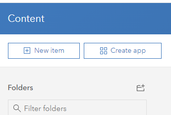

It looks like the Add Item feature of the Portal Contents tab no longer exists in Portal 11.  Does anyone have any suggestions on how to install an webapp extension in 11?
Any help appreciated.
Nicole_Ueberschär
Hi @DarrellConnelly ,
The Add Item button is now called New item but it should still be there:
DarrellConnelly
Hi @Nicole_Ueberschär
That button does not seem to allow for addition of a webapp widget extension.  Do you see something different?
Thanks,
Nicole_Ueberschär
Sorry, now I got what you are missing. I only always added custom widgets to the developer edition and then published that app including the widgets.
Did you try just uploading it without selecting a category first?
DarrellConnelly
Hi @Nicole_Ueberschär ,
I have tried uploading without selecting a category and the application did not recognize the manifest.
It would be tough to have to deploy webapp developer to install a pre-built extension.
Can I just install webapp developer and push the prebuilt extension to the portal?

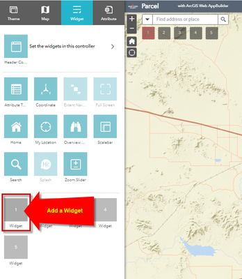

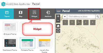

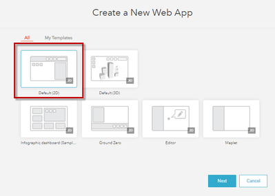

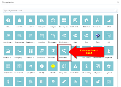

I ran into a problem with your Enhanced Search Widget 2.23.1 with Web AppBuilder 2.27.
The Widget Configuration Panel does not close after I press the OK button.
How to reproduce the problem
1.
Launch Web AppBuilder 2.27
2.
Create a New Project
3.
Select the Default (2D) Template
4.
Open the Widget Tab
5.
Add a Widget
6.
Add the Enhanced Search Widget 2.23.1
7.
Press the OK button.
The Configuration Window does not close.

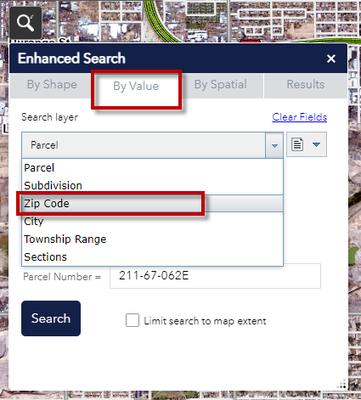

DavidDas__GISP
Hi Megan,
Robert Scheitlin has decided to take a break from the ESRI Community Forums.
I will try my best to help you.
The good news is that Robert’s Enhanced Search Widget version 2.23.1 works flawlessly with Web AppBuilder Developer Edition 2.27.

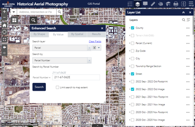

You can try out all the features in our Historical Aerial Photography App:
https://gis.maricopa.gov/GIO/HistoricalAerial
I have enabled all 4 Tabs in the Enhanced Search Widget.
  • By Shape
  • By Value
  • By Spatial
  • Results

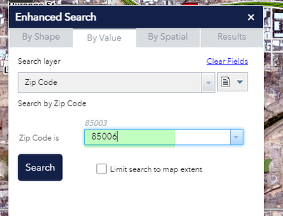

Open the By Value Tab and set your Search Layer = Zip Code
Select Zip Code = 85006 from the drop-down list.
Press Search
The map will zoom to Zip Code 85006.
It will be highlighted in orange.
There could be many reasons why you are getting the “Search failed” error message.
Robert made some changes to his latest version of his Enhanced Search Widget. This means configuration files that were created for earlier versions would no longer work. They would throw the “Search failed” error message.
The solution is to delete the old configuration file and start building a new one from scratch.
It could be other reasons like you are missing the proxy settings in your config.json file.
It could also be that you have not configured your own Geometry Service.

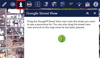

Good morning @DavidDas__GISP . Thank you for sharing you historical aerial link, it works flawlesly, for whatever reason robert's sample link never worked for me, looking at your site I notice you have the google street view working - Is that widget available for the community? Daniel.
PS. I hope @RobertScheitlin__GISP is doing OK.
DavidDas__GISP
Hi Daniel,
Sorry for the late response. I must have missed the notification.
Yes, we do have the Google Street View Widget in our WAB version of the Historical Aerials Web App.
https://gis.maricopa.gov/GIO/HistoricalAerial/
Robert Scheitlin made this custom widget.
This is version 2.1.
It needs a “googleapikey” from Google to make this work.
Robert took this down several years ago.
We created an Experience Builder version of the Historical Aerials using EXB Dev Edition 1.12
https://gis.maricopa.gov/GIO/HistoricalAerial/EXB
This one works a lot better!
It does not need a goggleapikey.
All this widget does is capture the centroid of your map and open a separate Google Maps Window where you can run Google Street View and view your surroundings in 2D/3D.
