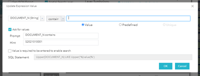

LindseyStone
Robert,
We are using your search widget for Subdivisions, Parcels, etc.  Some of our Subdivisions have apostrophes in the name and when doing the search if the apostrophe is included the search fails.  I'm guessing it has something to do with it being a symbol making the search error out, but I just wanted to double check to see if that is case or something else.
Also, you have the ability to Save the results to My Content.  Have you ever thought about putting in an option to save to CSV (like the attribute table does)?  Thinking for maps that are shared to everyone and being used by the public or staff with no login credentials.
RobertScheitlin__GISP
MVP Emeritus
@LindseyStone
Apostrophes should not be an issue as the eSearch will escape those when it submits the value to the search. CSV export is already an option you just need to enable it in the widgets settings. Which version of WAB and eSearch are you using?
MVP Emeritus
@LindseyStone  I see my issue with apostrophes now. In the widget.js replace this line
criteriaFromValue = queryExpr.replace(myPattern, content[s].value.toString());
with this:
criteriaFromValue = queryExpr.replace(myPattern, content[s].value.toString().replace(/'/g, "''"));
Only seems to be an issue when the search is configured for "string contains"
LindseyStone
@RobertScheitlin__GISP
That did the trick on apostrophes.  Thanks for the quick fix on that.
For the CSV.  I looked again since you said it is there and I must have looked over that a million times for that check box. Found it and works perfectly.
Thanks!

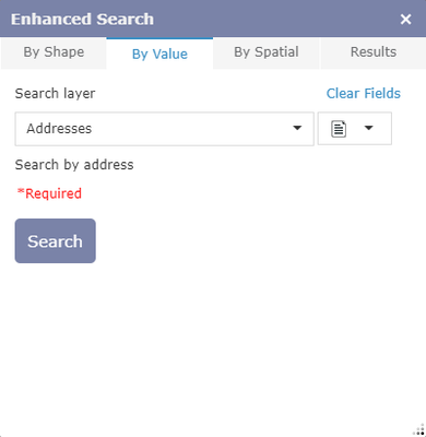

The other day it was brought to my attention that the search bar on the enhanced search widget has disappeared. Does anyone know how to fix this?
Thanks in advance.
MVP Emeritus
@cyoast
Have you updated the widgets configuration lately? It is possible for the UI of the widget to look like this when the widget is configured for no user input.

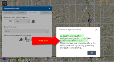

DavidDas__GISP
Please use Enhanced Search Widget version 2.21.1  on your Portal version 10.9.1.
I have verified this version of the Enhanced Search Widget to work flawlessly on Enterprise 10.9.1
I can configure the Enhanced Search Widget without any issues. All the Tabs – By Shape, By Value, By Spatial, Results – all work ok.
Here is an example of the Enhanced Search Widget 2.21.1 with all tabs enabled.
https://gis.maricopa.gov/GIO/HistoricalAerial/
I got this to work on Enterprise 10.9.1
Please make sure you are using Web AppBuilder Developer Edition 2.25

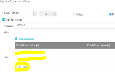

DanielMx

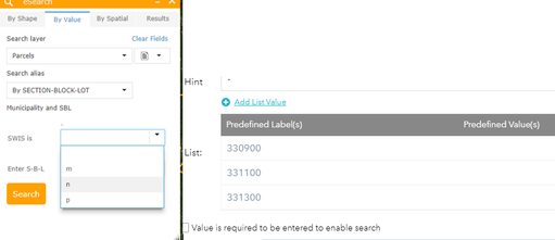

Has any one else has encounter the following issue and have a solution?
I'm have a long list of values to enter as predefined values, I entered about half of them took a brake and when I came back to enter the rest of them, the predefined labels were gone and replace with predefined values, do I have enter the full list at once or am I doing something wrong?
Thank you!
MVP Emeritus
@DanielMx  I have never had your situation occur. When you said you took a break do you mean you click ok on the "Add expression values" dialog or just leave WAB up and running with that dialog open and now the values you entered are missing?
DanielMx
Thank you for your fast response on both items.
I save the WAB app it was close to end of day yesterday, today I only added three values to test and I encounter the same issue.

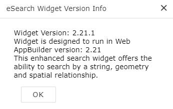

MVP Emeritus
@DanielMx
Sounds like it may be a bug. Can you confirm the version you are using? In WAB hold the "Alt" key and click anywhere on the eSearch widget and a dialog with version info will show.
DanielMx

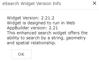

MVP Emeritus
@DanielMxI have found the issue in the settings dialog with pre-defined values and have updated the 2.21 download link with the fixed version (2.21.2 of eSearch widget).
DanielMx
@RobertScheitlin__GISP  Wow! that was fast, thank you very much, I will give it a try in a few.
DanielMx
No luck, not sure if it would help but the pre-defined values seem to moved to the pre-defined labels column, when I checked for the second time to make sure, then both pre-defined values & pre-defined labels were empty, it seems the pre-defined values moved to pre-defined labels every time the expression is open and since the second time were no values then everything was blank.

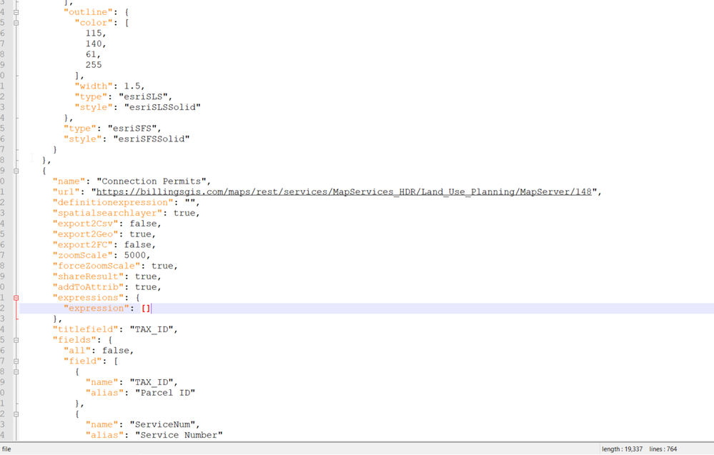

MVP Emeritus
@DanielMx  Is this app publicly available? I need to look at the widgets config.json so I can see what might be going wrong. Or you could just copy and paste the config.json portion for this layer.
DanielMx
