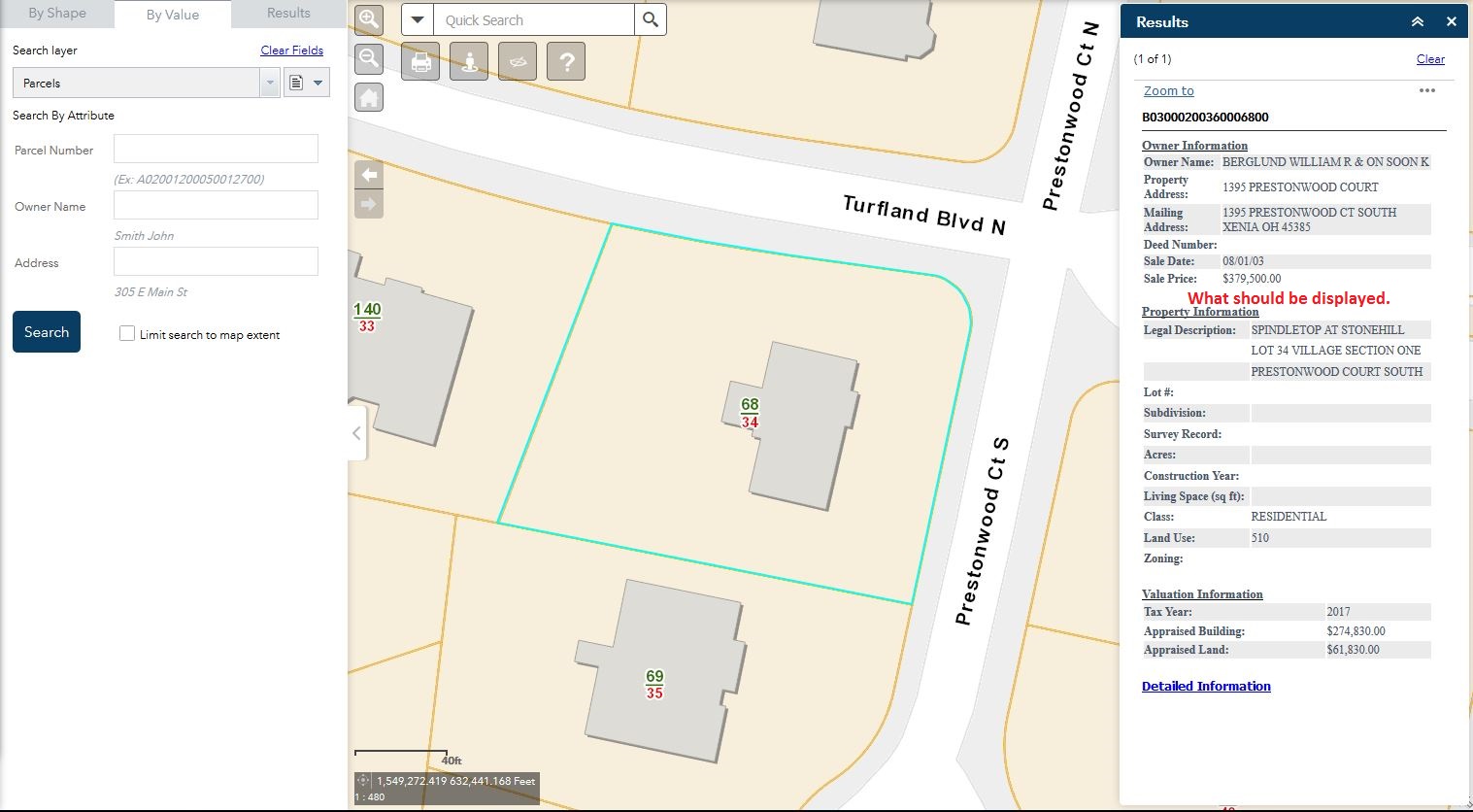

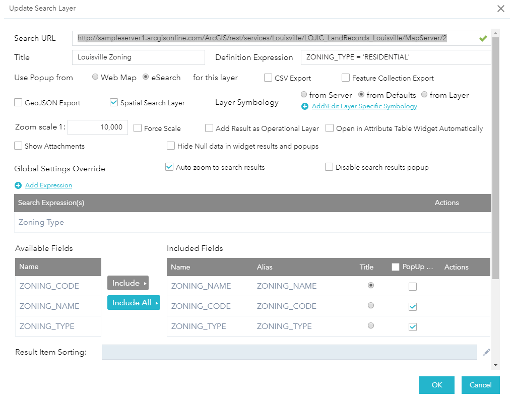

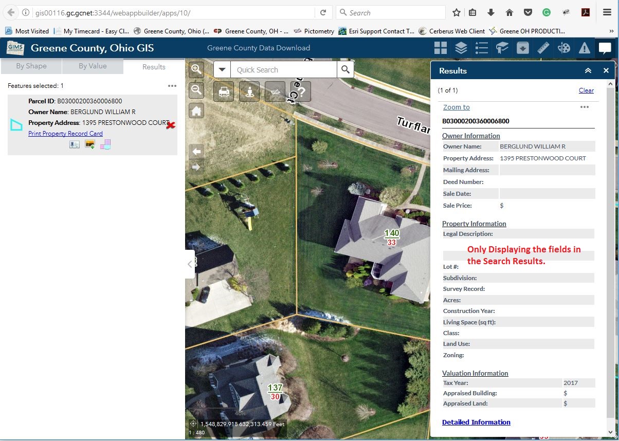

I'm getting unexpected results from the enhanced search v2.6. To be specific I have configured a search to only show a few fields in the results pane and want to use the PopUp Panel widget to display from the webmap. I understand there is an option to only display those certain fields in the popup, but I don't have it configured that way. I've attached screen shots to hopefully explain.
Also is it possible to automatically show the popup when esearch is performed instead of having to click on the result. Thanks for any information!

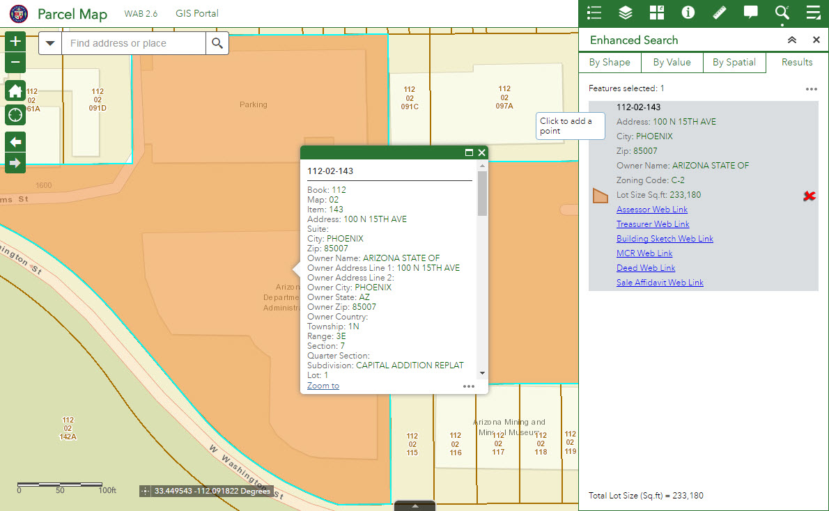

Martin,
  I am not sure but it seems like you are not understanding some of the widget settings.
When you (eSearch widget not involved) click on a parcel the popup panel will show all fields that are configured for the parcel.
If you use the eSearch a new layer is added to the map which would only have your three configured fields as attributes in the result. BUT if you choose "Use Popup from" "Web Map" then all the layers fields in the popup.
MartinOwens1
Maybe I am a little confused. I understand when you (eSearch widget not involved) click on a parcel the popup panel will show all fields that are configured for the parcel. But I figured if you configure the esearch to "Use Popup from" "Web Map" I would see all of the fields in the PopUp Panel widget since that's how it's set in the webmap.
MartinOwens1
I see what you're saying now. It's using the popup from the webmap but only displaying those fields that have been defined in the results. Is there a way to modify that? So that only certain fields are in the reults pane, but the PopUp Panel widget displays them all?

Martin,
   For that you need to add all the field to the eSearch widget and choose "popup only" for all the fields other than the ones you want in the results pane.
MartinOwens1
I'm an idiot. Thanks Robert! For whatever reason I was thinking if I set it to PopUp only it would exclude those fields from the results pane.

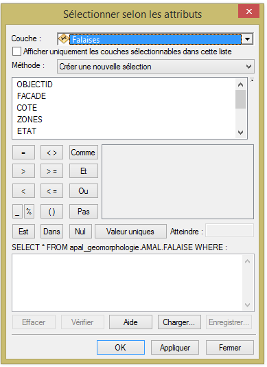

ikbelkachbouri
Is anyone familiar with a sample and/or previous implementation of a Query Builder for the JS API? I see where there is a Flex widget available but have not been able to find a JS counterpart.
I try geoprocessing with select by attribute but there is no query builder in widget .(expression query must be fixed in input ) .

ikbelkachbouri
Hi Robert ,
Please what about select by attribute with sql query builder like in arcmap  ??
RobertScheitlin__GISP
MVP Emeritus
Ikbel,
  Sorry there is no such widget in JS that I am aware of and currently I have no plans for that.

ikbelkachbouri
Thanks Robet . I had found this code about query builder but there is no attribute table . How can i please export the query result in the attribute table . http://arcgis.graphtech-gis.com/apps/SelectByAtt/
MVP Emeritus
Ikbel,
   This thread is for the eSearch widget. Unrelated questions should be asked in their own new thread.
