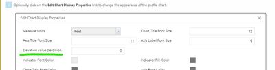

Hi there,
I am looking for the function to change the decimals in the tool. Now it is in 1 metre increments, but an accuracy of two decimal places is desired.
According to the help document, this function is under the button 'Edit Chart Display Properties'.
However, this option is not available in our configuration. Am I missing something, or can I activate this option in a .js file?
RobertScheitlin__GISP
MVP Emeritus
@RickKlopping If that configuration option is not showing then you might be using an older version of the widget that does not have that option. Update to the latest version.

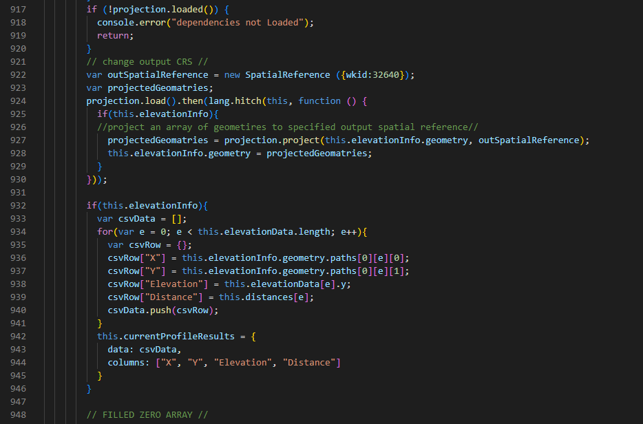

Dear Robert,
Thanks for your advices.
Is there any provision to change the projection before export the coordinates in the new version? or any plans to add this option?
Could you please advise me the change in the below code, if any? I am not able to export coordinates in my desired CRS. Please help me.
Thanks in advance.
MVP Emeritus
@Aneel_Kumar_M
What if any errors are listed in your browsers web console? I made the changes above to the widget and then drew a profile line near Dezful Iran and it worked fine.

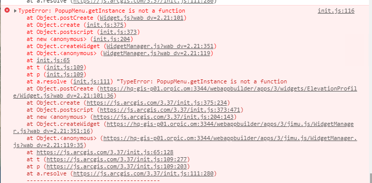

Aneel_Kumar_M
Dear Robert,
There is some error message in my  browsers web console, regarding projection.js, I am providing the snapshot while working and error time.
When it is working without modifications
After modification in widget.js
Is there any updates required or is it our cyber security or proxy?
Please advise, thank you
MVP Emeritus
@Aneel_Kumar_M  the error tells you your issue. A 404 error means the file can not be found. And the reason it can not be found is the projection does not have a capital "P", it is lower case "p". So in your require array you have
'esri/geometry/Projection',
when it should be
'esri/geometry/projection',
Aneel_Kumar_M

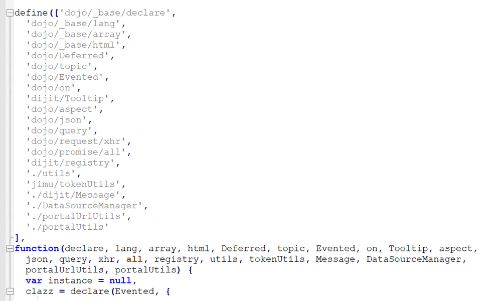

MVP Emeritus
Looks like you have some of your require module names and subsequent variables out of order. Each item in your define array has to match up with each variable in the preceding "function(" list.
define([
  'dojo/_base/declare',
  'jimu/BaseWidget',
  'dojo/Evented',
  function (declare, BaseWidget, Evented,
If you have one of these out of order then you have issues. But there are some modules like
'jimu/dijit/LoadingShelter' that do not have or need a subsequent variable.

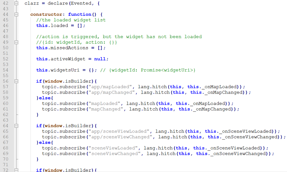

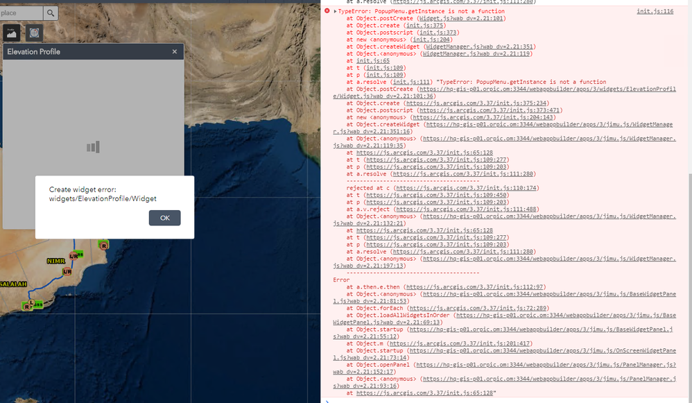

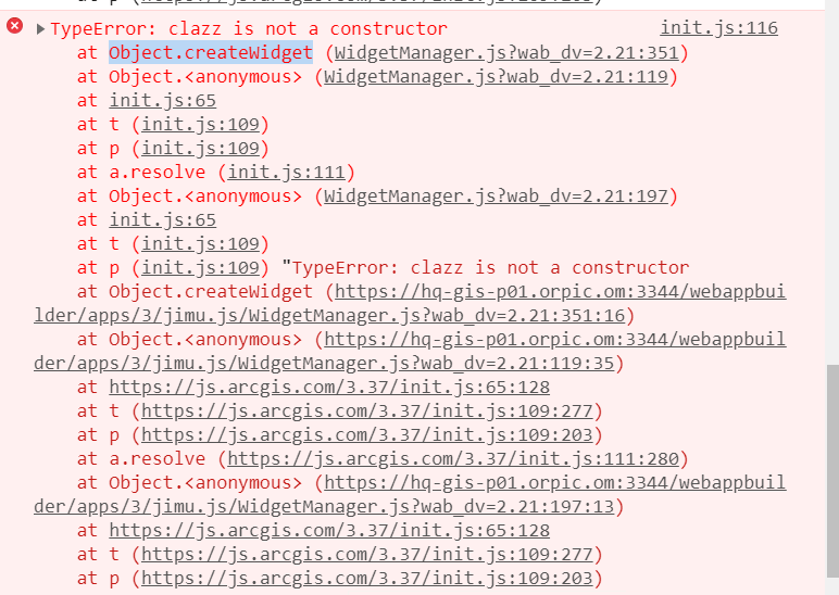

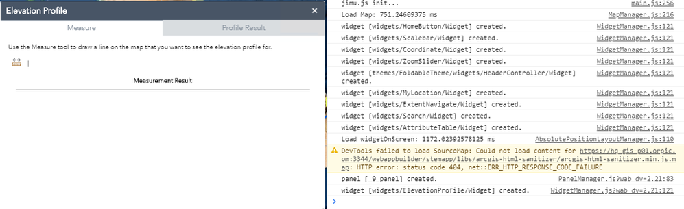

Aneel_Kumar_M
dear Robert,
I did not find the 'projection' and 'LoadingShelter' in the function (declare, .......), so I have added them, then I got some other error , show below:
I have seen the jimu.js/widgetmanager.js, snapshot shown below:
Could you please check and advice, thank you
MVP Emeritus
You should not be working inside the WidgetManager.js code. Your error is coming from the Elevation Profile Widget. So your changes need to be in the widget.js of the Elevation Profile widget only.

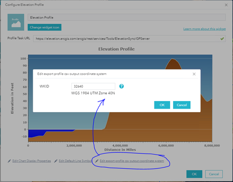

@Aneel_Kumar_M  Version 2.24 now has the setting to change the csv coordinates.

Aneel_Kumar_M
Dear Robert,
Thanks for the update, now I loaded version 2.24, I got what I wanted 🕺💃🕺, great tool
Thank you so much and I appreciate your timely support 🙏🌹👏.
