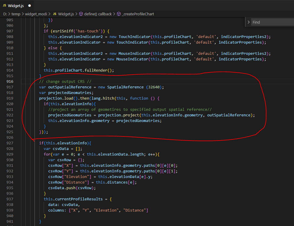

  1. Added setting to change the coordinate system (WKID) of the exported profiles csv coordinates.

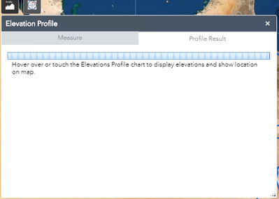

Not sure if the icon is missing or just black on black, thoughts?
Missing Icon in pop up
Thanks,
Mike
RobertScheitlin__GISP
MVP Emeritus
Michael,
  Looks like a dark icon issue. I will have to look into this.

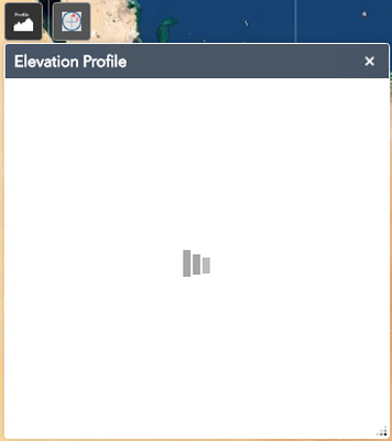

GeoguichetGeoguichet
Hello again.
I was auto-activating the nmeasurement tool with
this.measureTool.setTool("distance",true);
in onOpen().
Without that, I've no more JS error, but the widget shows empty/blank, so I guess there is a problem with dojo.measurement somewhere, but don't know what could have changed here with 10.8.1, if WAB is same
MVP Emeritus
@GeoguichetGeoguichet , Each version of Portal uses a different version of WAB.
https://enterprise.arcgis.com/en/web-appbuilder/latest/create-apps/about-versions.htm
for example Portal 10.8.1 uses WAB 2.16. You should try to download the latest version of this widget.

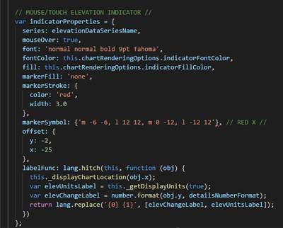

Hi! I'm a beginner in dev and I was hoping that que Red X (on the chart but also on the map line) could be costumized with a bike symbol.
I suppose it's somewhere here:
But, i don't know how to change it to but a image src.
Thanks for your help!
MVP Emeritus
@FannyFortin-Delmar1
That is the correct code location for the red X in the chart. To replace that with a bike in the chart you would have to get SVG code for a bike symbol and replace that section.
markerSymbol: 'm -6 -6, l 12 12, m 0 -12, l -12 12', // RED X //
For the red X on the map it is this line that would have to be changed:
var chartLocationSymbol = new SimpleMarkerSymbol(SimpleMarkerSymbol.STYLE_X, 13, outline, red);
You could change the SimpleMarkerSymbol to a PictureMarkerSymbol.
The second half of your request is quite complicated and will not be possible for someone who is a beginner in development.

Aneel_Kumar_M
Dear Robert,
Firstly, it is very helpful and great widget to deal with elevation data.
I am trying to export x,y values in WGS84_UTM_zone40 (32640) and I have added the advised code (from one of the posts, deleted-user.***..) in widget.js as shown below
But, when i am trying to run the tool, it looks something wrong, it is keep on showing status bar.... as shown below
The tool was working before I modify and I am able to export csv file too.
Is there any place I need to change, or any other js files i need to modify ?
do I need to change wkid anywhere?
please advice me.
thanks in advance.
MVP Emeritus
@Aneel_Kumar_M
Have you added the
esri/geometry/projection
AMD module to the require list at the beginning of the widgets code?
https://developers.arcgis.com/javascript/3/jsapi/esri.geometry.projection-amd.html

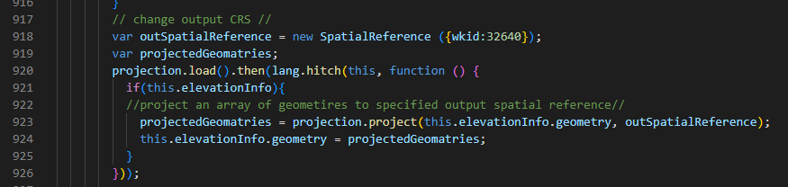

Aneel_Kumar_M
Dear Robert,
thank you for the reply,
Now I have added it

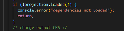

Then I try to test, its loading.... no message
I have added to check the dependencies loaded or not , but no error msg
anything missing, any other file I need edit ?
please advise, thank you
MVP Emeritus
@Aneel_Kumar_M  The fact that the widget is showing just loading tells me that you have your require modules and their subsequent variables out of alignment (a very common AMD coding mistake that beginners make).
