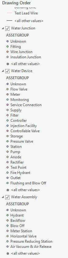

Hello,
I have a problem with Deploy an ArcGIS Solution > Utility Network > Water Distribution Utility Network, I don`t have a maps or any layers to the Contents and also symbology for water utility are empty.
Screenshots posted below.
How can I solve this issue?
Thanks,
Katherine

In the catalog pane, what is in the maps section?
KaterynaHolubenko
Yeah,thanks, there are Water Distribution Simple Network and Water Distribution UtilityNetwork.
Thats all that need to be?
MikeMillerGIS
Esri Frequent Contributor
Yes, those maps would be repointed to you EGDB after you create the Utility Network from the asset package.

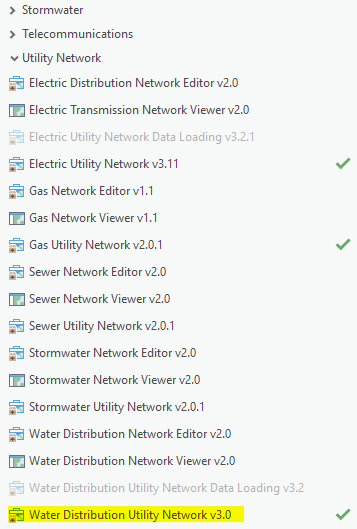

SrinivasaRao1
Hi, Can you please let me know where are Water Distribution Simple Network and Water Distribution UtilityNetwork... I can see Water Distribution Utility network.
