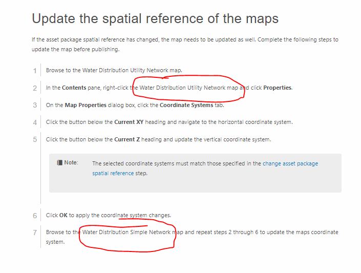

Also we are not able to understand this step as well.
Where we can see these two maps. We could only see only one. Please suggest.

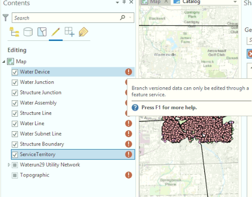

PaulLeBlanc1
Those red exclamation points are whether the layer can be edited or not. Because you are branch versioned, it is expected behavior that you cannot edit (you must publish and edit via services).
You can swap to this view mode:

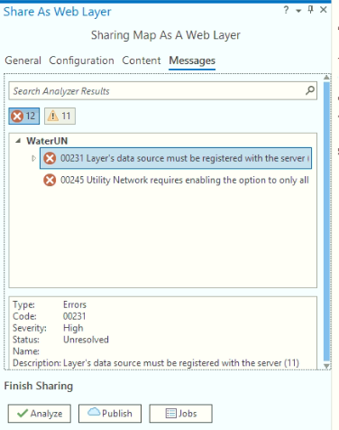

We are not able to proceed this step" Publish the feature service" after ignoring below steps and below is the error.
Repair the utility network maps
Update the spatial reference of the maps
It is showing errors as below
PaulLeBlanc1
You need to register your data with server. (If you right-click the error, it will present you with some choices.)
