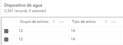

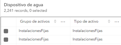

There is an issue I am not able to overcome and I am not really sure how to solve it. I have shared a Utility Network web Feature Layer from ArcGIS Pro into a portal and all the layers: Water Device, Water Junction, Water Line, etc. have their correspondent textual names when either opening the attribute table or clicking in a pop-up in Map Viewer: Tanks, Junctions, Lines, or whatever name they might have. (Please see the first screenshot below for the "InstalacionesFijas" layer within Water Device - be aware the names are in Spanish-)
However, when sharing a Web Map from ArcGIS Pro, into the same portal, using these Feature Layers as the data source, having symbology, grouped layers, etc. the textual names are overwritten by the coded domains IDs, and instead of InstalacionesFijas, ID number 12 and 14 are displayed (Please see the second screenshot below for a Water Device layer):

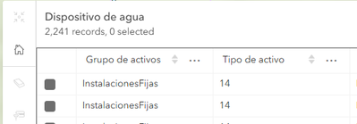

Going furhter and publishing a Web Map only using the raw Feature Layer dragged into an ArcGIS Pro map  (with no symbology, or grouped layers, no filters, etc.) the attribute table in Map Viewer shows the textual Asset Group name (InstalacionesFijas) and the coded domain ID (14):

Thank you very much for your answer. We always say Yes to the "Do you want to add all classes that participate in the Utility Network to the map" question and when publishing the service, the asset group/asset types names are being displayed correctly.
Exactly, as we use the symbology in ArcGIS Pro based on other fields (subnetworkname, isconnected, issubnetworkcontroller, etc.) when publishing the web map  the Asset Group - Asset Type names are "lost" and only the IDs are showing. So, how can we see the Asset Group - Asset Type names instead of the coded values IDs if we use a symbology based on other fields?

Thank you Robert,
We have done as you said, saving the web map in ArcGIS Enterprise, and the Asset Group shows the coded ID domain (3, 4, 7, 17, etc.) and the Asset Type shows the textual name (Tanks, valves, or whatever) in one of the web maps.
However, following the same solution, it shows both Asset Group - Asset Types textual names in a different web map we have published earlier on, hence this behaves randomly. We will log a case with support.
