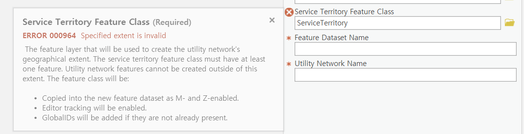

MinShin
Hi Don,
I am setting up Water Distribution Utility Network Configuration again. This time I changed Asset Package Spatial Reference to "Korea 2000 Central Belt". This tool run with out an error. But when I try to Stage Utility Network, I get this "Spatial Extent is invalid" error.
Is there any way to work around this?
Thanks for your help.
Regards,
Min
DonCarson
Hi Min,
Please log this issue with our technical support group so we can work closely with you to ID the issue and assist with resolution.
Thanks,
Don Carson| Esri Professional Services | Manager, Utilities, Telecom, & Pipeline Consulting Practice T: 972-699-0014 ext. 5668 | M: 214-755-8487 | E:[email protected]<mailto:[email protected]> | esri.com/services<www.esri.com/services>
