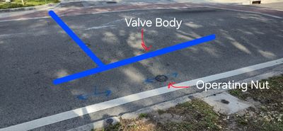

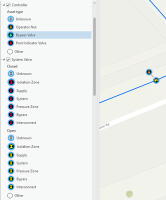

We are currently GPSing our assets and when adding system valves we gps the top of the valve box. So while digitizing record plans we are given coordinates for the operating nut as well as the valve body. We are trying to find the best way to display that in Pro. Below is how we are trying to display it so the valve is not floating, but it also causes issues with out locators displayed in the last picture when they locate the area.

I would definitely keep the valve body in line with the mains.  When we have a butterfly valve where the nut is offset from center, we just show the GPS points for the nut and have it displayed.  This way the topology stays intact and our locators/field crews can still locate the operator nut.

I would recommend having the operating nut be a separate feature in the GIS with its own symbology. It would also be good to show a connection from the operating nut to the valve it operates or have a relationship between the two. Here's an example of how this is handled in the utility network, where an operating nut has a connectivity association with a system valve.

Thanks for this, we have a ways to go before we are ready for the UN, but we just setup topology rules to start cleaning up our data and this was something we have been discussing. So currently we record the system valve and operating nut in one field because probably 98% of our valves are gate valves and the nut is directly on top. Would we only use the operating nut feature when it's offset and would the connection between the two be visible without a actual line feature.
