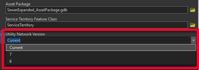

I downloaded the Stormwater Utility Network off the solution site and I'm having a Pro compatibility issue.  Looks like everything in the solution was created in Pro 3.3, but when trying to apply an asset package to my enterprise geodatabase I'm getting the below error message.  I'm trying to use Pro 3.1 because I need a version 6 of the utility network,  since Field Maps does not support UN version 7.  I'm on Enterprise 11.3.  Is there anyway to remove unsupported fields, export this out to a new asset package or get a compatible version of the Solution?
ERROR 160627: This version of the Geodatabase client is incompatible with the dataset and cannot open it.
Failed to execute (ExportXMLWorkspaceDocument).
PatrickGCowan
You don't have to use Pro 3.1 in order to make a UN version 6. The UN Tools now has an option to pick which version you want to create when using the Asset Package to Geodatabase or Stage Utility Network tools. This will allow you to create a version 6 UN with Pro 3.3 or higher.
