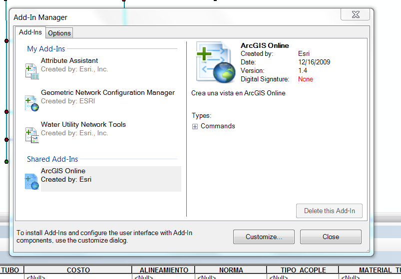

MarcelaRondon
absolutly positive on the ArcGIS 10.2, i assume i have the other one since i currently have this other add-ins  and diagrammer working...
