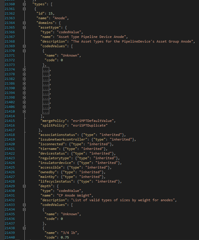

  I just revisited this and @ 10.6.1 with ArcGIS Pro 2.2.1 I lose domains and subtype descriptions in my map document definition in a shared web map even if I symbolize using only the subtype field.  If I look at the map definition I can see that the domains element is blank (even though the field has domains) and even though the type has an id its still unrecognized as a subtype by the map (I wouldn't the order would matter, but the id is typically at the beginning of the json element but for a pro web map its located at the end).
"types": [           {             "name": "Anode",             "domains": {                            },             "templates": [               {                 "name": "Anode",                 "prototype": {                   "attributes": {                     "assetgroup": 15,                     "assettype": 0,                     "rotation": 0,                     "insulatordevice": 0,                     "ownedby": 1,                     "cpsubnetworkname": "Unknown",                     "depth": 0,                     "terminalconfiguration": "Default",                     "devicestatus": 1,                     "accessible": 1,                     "maintby": 1,                     "lifecyclestatus": 3                   }                 },                 "drawingTool": "esriFeatureEditToolPoint"               }             ],             "id": 15           },

I am not sure, can you zip up the entire rest def so I can look at it?
RobertKrisher
I've included a copy of the service definition and the ArcGIS Pro Web Map definition.  I thought about including the web map definition from a map created in ArcGIS Enterprise, but it behaves exactly as you described 😃
MikeMillerGIS
Esri Frequent Contributor
The service def looks correct.  You can see the definition in the types.  The layer definition in the webmap from ArcGIS Pro looks wrong.  Looks like a legit bug.  I would suggest logging it.
Service Def
Layer Def in webmap from pro
