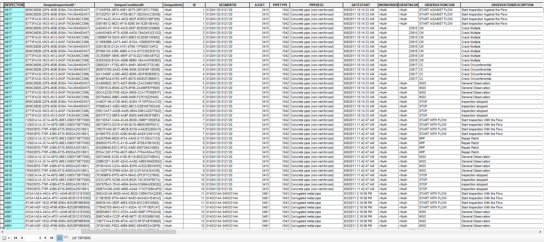

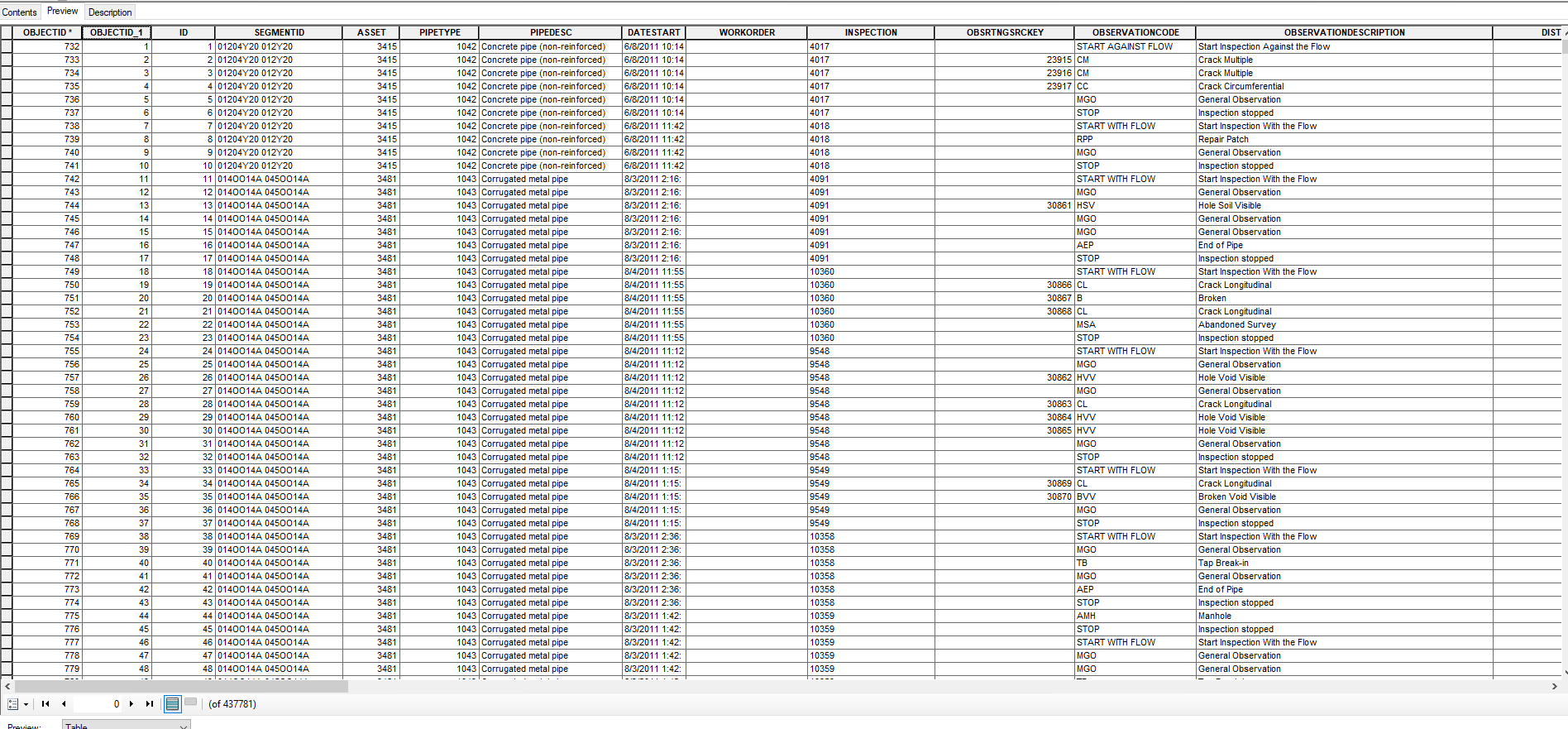

I'm running the CCTV Solution and for some reason it's creating 4 or more duplicate conditions.  In the original conditions table I can see there are only 10 conditions for inspection 4017 in the screenshot below. First image is the CCTV Conditions table that gets created, second is the original conditions table.  My continuous field is blank because we don't track that.  Any ideas why it may be creating so many duplicates?
