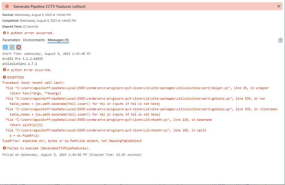

I keep getting this error when I am trying to run Generate Pipeline CCTV Features tool.Capture.PNGI was inserting my data within the model and had no success, so I decided to try and run the sample data that esri provided and am getting the same error message.
Any help or suggestions is appreciated!

Hi Kayla,
The fix is complete for CCTV Manager. Please update the utilsolutions toolbox to the newest version, 2.7.2.
AlexKabak
Hi Kayla,
Thanks for bringing this to our attention. I was able to reproduce the error and we are looking into it. When it is fixed I will reply back to this thread.
AlexKabak
Hi Kayla,
