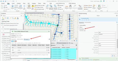

We are developing a similar solution to what you suggested. We created a network attribute to leverage the default trace function, enabling us to summarize the entire service connection flow within the trace:
At this stage, we aim to summarize the flow by using the asset ID to identify the specific distribution path for each water line, helping us determine if connecting a new customer to the water line is feasible. Can we achieve this with the default tool, or do we need the summary statistics tool?
Thanks in advance!
