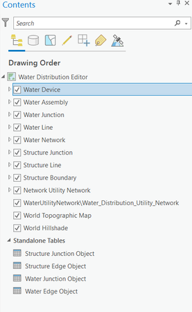

So just to make sure, this error message points to the TerminalConfiguration (Alias: Terminal Path) field in WaterDevice feature class and a terminal name or *  is required in the mentioned devices in the error message?
If I got that right, I still am confused as how to fix the issue as the value of those devices are same as other devices that are not highlighted in the error message. the Terminal Path values are set as default for all the devices.
Like, in the below screenshot first device is mentioned in the error message but the 2nd one is notpragyasrivastava_0-1647000455692.png
Please let me know if that's what you meant.

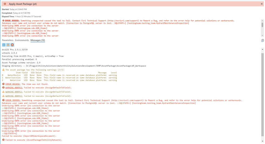

Thanks for helping me find B_rules table. I did set the terminal names '*' and ran the Apply Asset Package tool again. I didn't get any terminal configuration related error this time. However, tool failed again and I got another error:
It says report a bug and also mentions error related to the server connection. I see all the sde connections working fine though.
